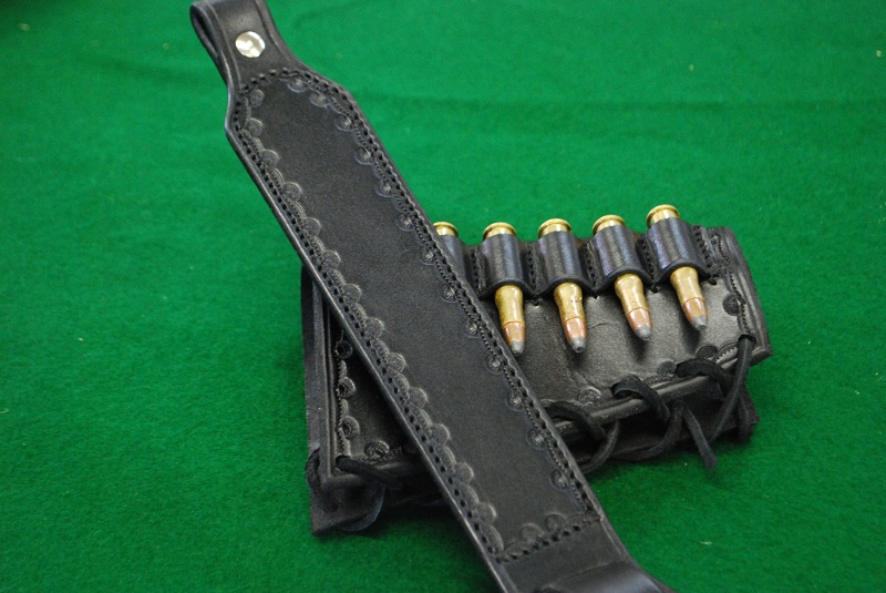

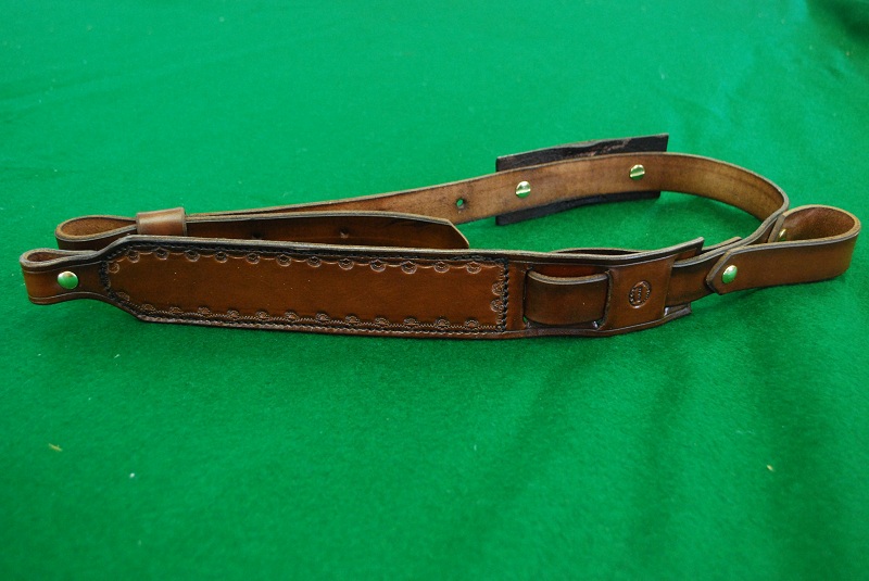

I use 8-10 oz as even with the smallest solid chicago screws they won't tighten up on two layers of lighter leather. The pad is personal preference - I just try to cover the shoulder.
post-19170-098293000 1335354556_thumb.jp
post-19170-034900400 1335354560_thumb.jp
post-19170-000144900 1335354564_thumb.jp
post-19170-044598400 1335354569_thumb.jp
Eaglestroker thank you for the reply. Those slings look really nice. When applying the pad and suede or other material on to the sling What is your aproach to triming it to fit the rifle sling? Just wondering cause I've never did it before. John
John,
I always use split pigskins as its very lightweight. The thicker the material the more hassle it is getting the glue to hold. I use contact cement to attach the neoprene pad, then the same to attach the pad, then stitch. I ordered a large quantity of the neoprene and would be happy to send you a small piece to try. After its stitched I go back and trim the excess material close to the stitching. I mark the stitch line and use my awl to mark the bottom corners and top of the arc to locate the pad, which is only slightly smaller than the area.
