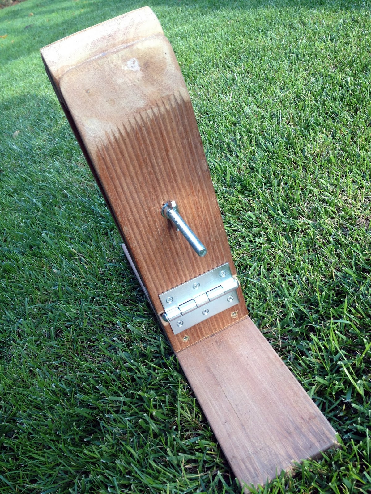

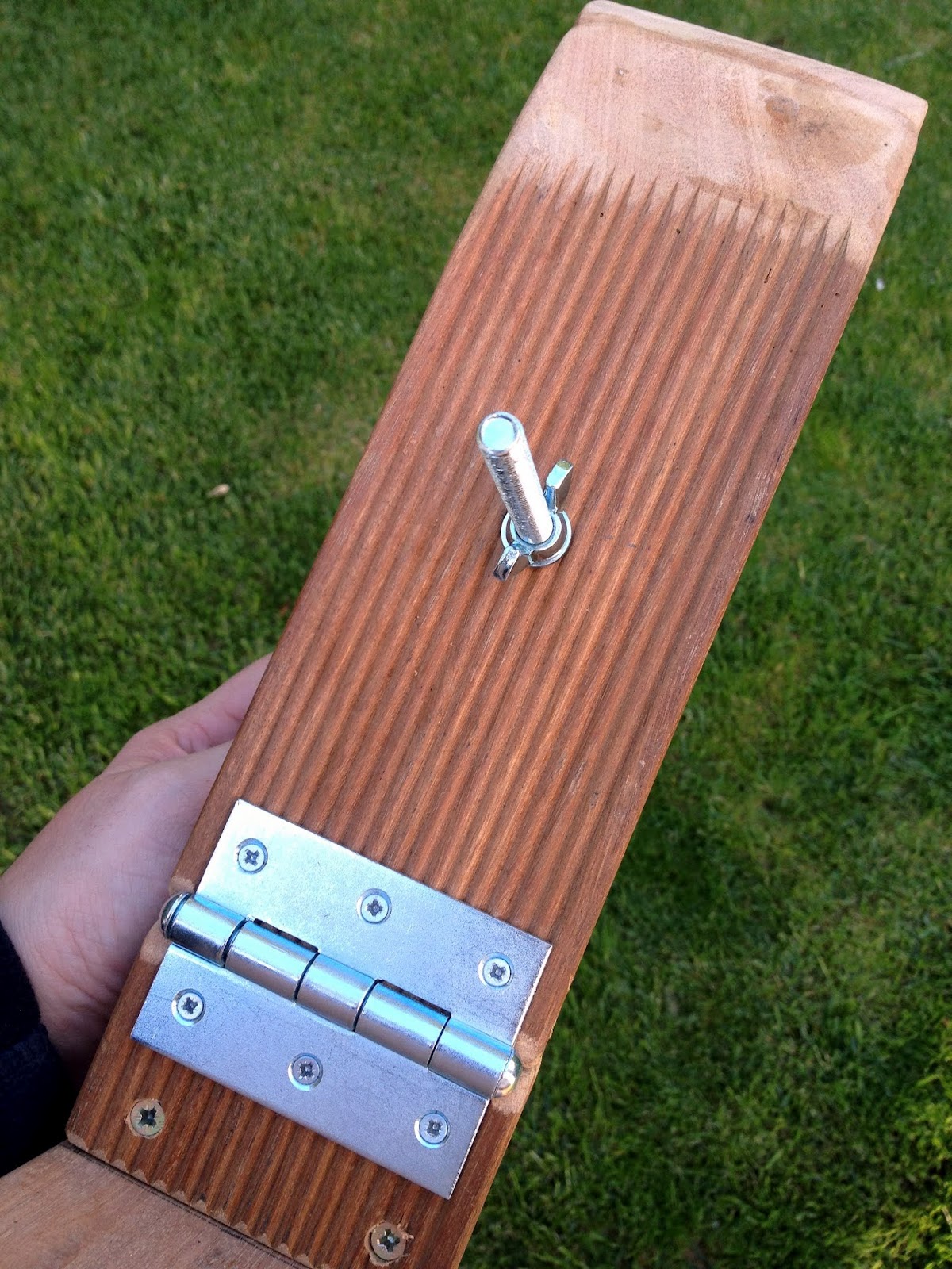

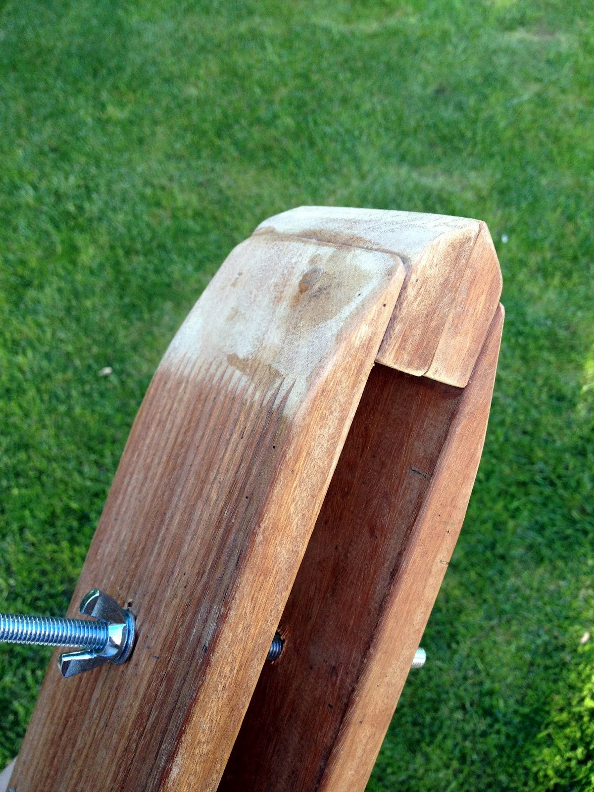

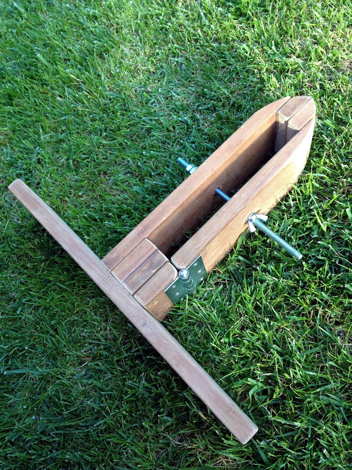

In the last 2 days i have been occupied with the making of a Stitching pony that i was planning to do for some time now. This equipment will help me allot in the tedious process of stitching my leather work.

Nice job. I do think you are going to want to shorten that threaded rod, allot. Nice pony.
I like it, it looks well built, better than the one I use!
The pony looks great! Definitely much better than the one I have=)
You might want to try to fit a quick release bolt instead of a regular one though.
Looks good.
I would replace that rod with a carriage bolt, put a coil spring on the bolt between the jaws so the jaws open on their own then put a flap of leather with a snap over the wing nut so your thread doesn't keep catching it.
thank you all for your comments and suggestions. I am considering making the changes that Tree Reaper said. As soon as i get the hardware i will update my original post
