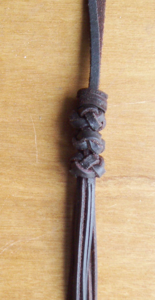

i recently started braiding dog show leashes with 4 strand round braid of 3/32 kangaroo leather. I am adding beads or gems along the braid and need to find a good terminal knot to use to keep the beads from slipping. Currently I am using a Turks Head Terminal Knot as described in the Encyclopedia of Rawhide and Leather Braiding but I am wondering if there is something that would be more sutable. I need for the strands to extend from the center of the know (or button) so I can continue braiding. Any suggestions?

Yep. That's it. I thing the Turks's Head is the same as a crown knot and then I make a wall around it, threading the strands back through the X's to come out the middle. Seems like I was having trouble with the last strand, getting it threaded back through the correct way. But that's seems to be going better for me now. Probably a bit of practice helps :) . I'll attach a photo of the knot I am using. I would love to have your diagram. it always helps to see it on paper. Let me know more about your planned project and I can send you photos of the leashes I have done.

This link with pictures may be better than my drawing!
http://www.falconryforum.co.uk/showthread.php?t=18469
Though I would add to the good instructions and pics that at the end of the first stage as shown in posts 5 and 6, do not tighten it so much as shown in post 6. Just tighten enough to just about stop it falling apart while you work. This will make it easier to do the second sgae of the knot and ensure that you can twist any strands so that the grain and flesh sides are the right way. you can then tighten each strand in turn .
I hope I am not trying to teach my Grandad how to suck eggs, but if you need to loosen the knot a little, ( in order to manipulate some wayward strands) this can be done by taking exact opposite strands from the centre and tugging them outwards.
