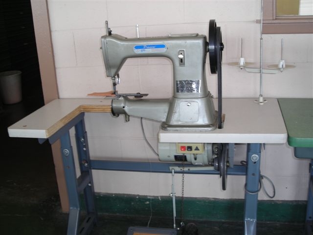

FHL FERG Report post Posted May 8, 2012 (edited) I am looking for info on a Prosew Model M 120-2 cylinder arm machine. I need to know what it's capable of, foot type, lift, needle and thread sizes, etc... Several google searches turned up nada...... :/ Edited May 8, 2012 by FHL FERG Quote Share this post Link to post Share on other sites
Wizcrafts Report post Posted May 8, 2012 (edited) That machine resembles a Cowboy CB2500 and Techsew GA5-1. If this machine has the same specs, it can sew up to 7/16 inch of leather, using needle sizes 23 through 26 (plus or minus a size). It can handle thread sizes 138 through 346. Like the aforementioned machines, it will be bottom feed only, with a flat fixed presser foot and has a large cylindrical bobbin. These machines are based on the ancient Singer 45k25. They are good machines for sewing just under a half inch, but where the tooth marks on the bottom are not normally seen, or considered unacceptable by the end buyers of the goods produced on the machine. Edited May 8, 2012 by Wizcrafts Quote Share this post Link to post Share on other sites
