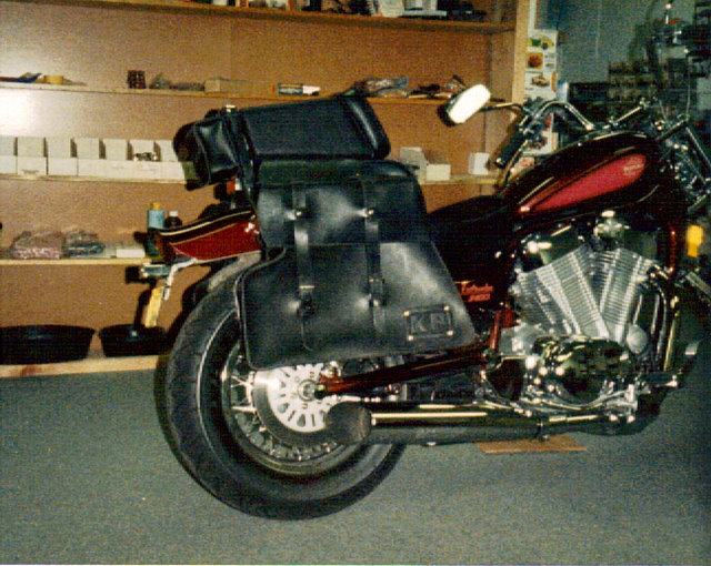

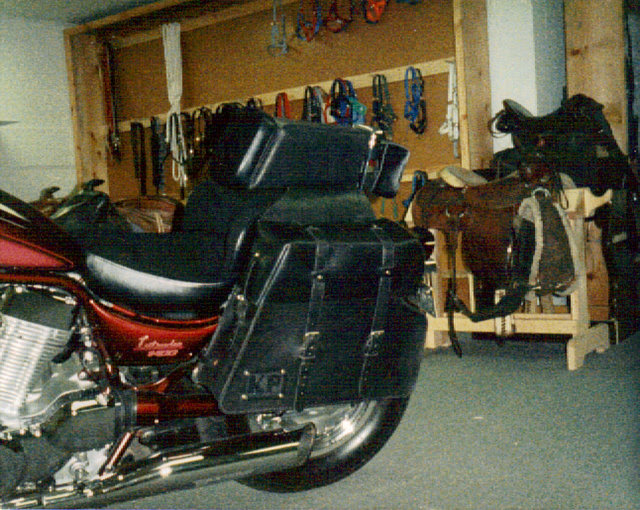

Contributing Member rdb Posted January 19, 2008 Author Contributing Member Report Posted January 19, 2008 (edited) Update: This is the final prototype, THANX EVERYONE for your help. I will still change things, like maybe relocating the dee rings to the side, a lining, and maybe a stiffener, but it looks good in the hand, actually better than the photos show. Edited March 2, 2008 by Johanna reduced pic sizes Quote Web page Facebook

Contributing Member rdb Posted January 19, 2008 Author Contributing Member Report Posted January 19, 2008 As I noted above, I don't like slots in things generally. If I use them like on my guitar straps, it's through two or more layers of leather. This proto was made just to see if i could make a product similar to what I've seen (which wasn't much). Having looked at gearsmithy and beeza's photos, I went for the traditional style. I think it's always best when you start something new, to follow "them that's come before ya" I don't believe they get any less for their traditionally slotted work, so it's fair to say, it's an accepted practice. You are right about the dee rings. Originally I had intended to hang the bag from them, and just tighten with the long strap, but after modifying the bag to the slots, I didn't want to leave the holes from the dee rings, so I just left them on. The buckle straps slide through them now, so that's what keeps the straps sort of straight. As I noted above, if I use them, I will move them to the stitching line sides. I will improve the whole thing, now that I've done one the regular way, and I'm definitely taking notes from all youse guys, very thankfully. As yet in my re-startup of the leather trade, I haven't run into anyone who is willing to come up with the money for the hand stitching work, just running into regular folk willing to spend a tad more than what's in the stores, but if I do, I'll sell the stuffing out of the hand stitching. Just wish for a machine to be able to keep prices reasonable to more people. An old saying: "I'ld rather make a quick nickel, than a slooow dime"....lol Quote Web page Facebook
