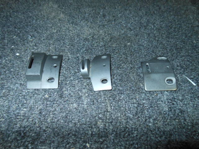

Members Cobra Tom Posted June 29, 2012 Members Report Posted June 29, 2012 Dear Trox, The COBRA Class 4 (16.5 inch cylinder arm) comes with the standard needle plate and a smooth feed dog. The holster, stirrup and slotted plates are optional, they require removing the feed dog. The standard center foot is open. Tom - Leather Machine Co., Inc. [Thank you Dirtclod, Bruce and Art, This answered my first question; I decided to choose the stirrup plate. The paddle foot looks very clever too, I often have problems with my other walking foot machines, sewing along the edge and rounding a corner. The vibrating presser go outside the edge, the paddle foot will resolve this problem. And if they do not work out, they can be altered in to a harness foot. I agree with Art the center presser has to be opened or else I have to sew blind. (I see a lot of this closed foot on Chinese equipment, they are useless in my opinion) I understand you all have different versions of the 441 clone. Bruce you use the Pro 2000, Art you use the Cobra 4, I guess Dirtclod also use the Cobra? I believe the Cobra comes with the slotted plate as a standard, and then the machine only uses its top feed. When other machines like the Cowboy 4500, comes with a smooth feed dog and a standard needle plate, using their triple feed. I would very much like your opinion on this too. I also use a Pfaff cylinder bed and a Dürkopp Adler flat bed for my smaller work. They are both triple feed and uses feed dogs. The Pfaff uses a smooth feed dog and on both machines has their feed dogs set in level with the needle plate. None of them tends to mark the underside of the leather much. However, on the big stitchers, the foot pressure will increase and it will likely be a bigger issue here. (I am used to bottom feed heavy stitchers and know of the tricks to avoid markings) What is your experience on this matter? In advance thanks. Trox Quote

Members Cobra Tom Posted June 29, 2012 Members Report Posted June 29, 2012 Dear Trox, I attached some photos of the optional plates and feet. I did not have one for the left and right toe feet, but imagine each half of the double toe foot as a separate foot. Thank you Tom for clearing this up, you are working together with Steve I presume. I tried to sew some veg.-tanned leather on my machine with the standard plate and feed dog. Most of the markings underneath seem to come from the small groves in the blanket needle plate. Those groves can be grinded of and polished, and with a smooth feed dog, it will be just fine. Are your Cobra standard plates smooth? >>>>>>>>>>>Yes, our standard needle plates are smooth. Look at the first two photos. I also have two small issues with my machine, they might be related. The foot pedal jumps up and down when sewing (it sounds like some big agriculture machine, compared to my Adler's), It do not disturb the sewing, but is very annoying. The stitch length on full is also to long; 16 mm, it has to be 11 mm. >>>>>>>>>>>>>You can adjust your stitch length setting with the little wheel in the forward/reverse lever. I would not worry that your maximum stitch length is longer than you expect from that brand unless the feed dog makes contact with the plate. I have not had the time to read the service manual yet, when I adjust the stitch-length, maybe the pedal issue is gone too? >>>>>>>>>>>It could be that the chain which connects to the machine's lift mechanism on the foot pedal is too tight. It should have little bit of slack. I am not certain but that would be my first guess. (It backtacks in the same holes and the needle do not hit anything, despites it long stitch length). Is this right? >>>>>>>>>>Yes, the needle should go through the same holes in reverse. It is more that do not add up to the machine specs too. This machine is produced in 2007 and sold in France. The foot lift is supposed to be only 20 mm, (on your later machines the foot lift is increased to 1 1/8 inch) I measured mine it to be 24, 6 mm, about one inch. What is changed in the newer machines to increase the foot lift, it uses the same needle system 794 (7x3). Do you know the answer to this? >>>>>>>>>>>>I think it was done by increasing the length of one of the arms (or linkages) in the lift mechanism. In the U.S we say the bigger the better. :-) (I believe this was three questions, bare with me please). When you ask 3 questions you get the 4th for free. In advance thanks. (I am sorry for the bad pictures, old Iphone) Trox Quote
