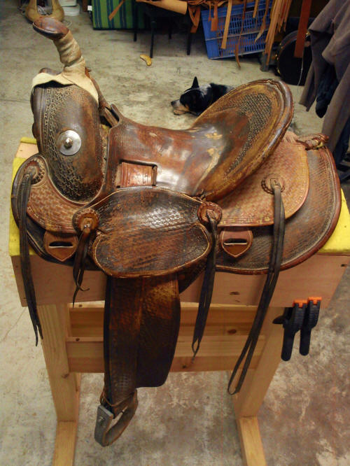

One of my friend received a gift of an old saddle. It is the saddle from Visalia company. Is a in very poor condition, with a broken fork and cantle, very unprofessionally repaired. A friend received information that the saddle is more than 100 years old. BUT ..... I am very closely at this saddle and I discovered that the tree is FIBERGLASS covered. Does anyone have any information please when it began using fiberglass cover of tree? I think that it was later than 100 years ago
Thanks
Martin
post-16366-0-81574100-1352065002_thumb.j
This saddle has some features that would indicate that it is early saddle. Eight buttons. loop seat, seperate seat jocket, exposed stirrup leathers. You can see where the rear jockey and front jockeys have been replaced. Is it possible that saddle was stripped to the tree and the rawhide may have decayed or cracked and repaired with fiberglass. Fiberglass was around in 1940's more mainstream by 1950. I would not think the original tree was fiberglass. Visalia moved to San Fransico in early 1900, but the visalia stamp on the seat still read visalia Ca., but the cantle back makers stamp read San Fransico, with a serial #.
Steve

After long time i saw this saddle again. On cantle is oval brand"VISALIA STOCK SADDLE Co. SAN FRANCISCO CA. with number 6970 in center of brand
Have anybody some next infos about age of this saddle?
Thanks
