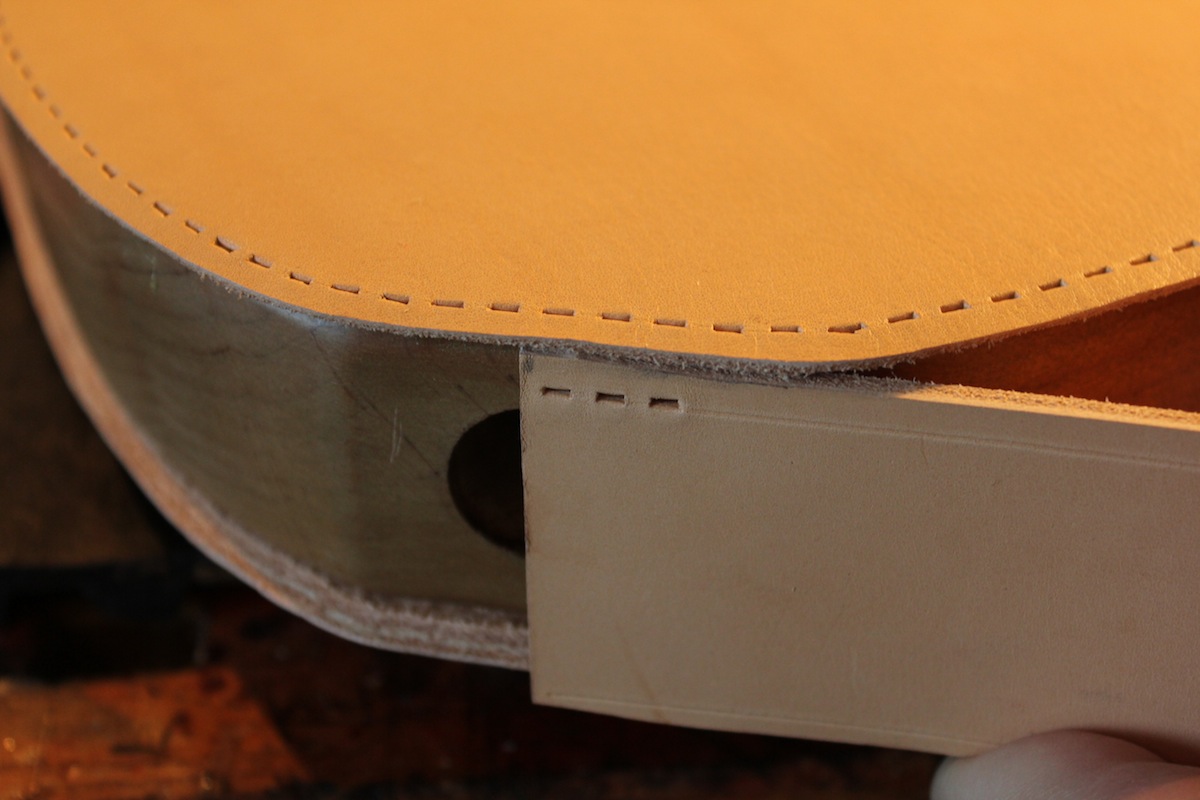

STEP 4:
A: Using your wing divider marks and a slot 3 prong punch and a 1 prong slot punch start making slot holes around the perimeter of the top and rear pieces.
***When you arrive at the neck joint you must be very careful to leave yourself 5mm from the last hole so it takes some lining up and eyeballing not to go past where the leather will be cut out from the neck pocket.

STEP 6:
A: Get out your Edge trimmer and set yourself at 45Degrees and cut from the edge of the leather to your marks you just made. Press down VERY hard so you don't get under the leather. You want to be just on the edge at a 45 degree angle not cutting into your slots.

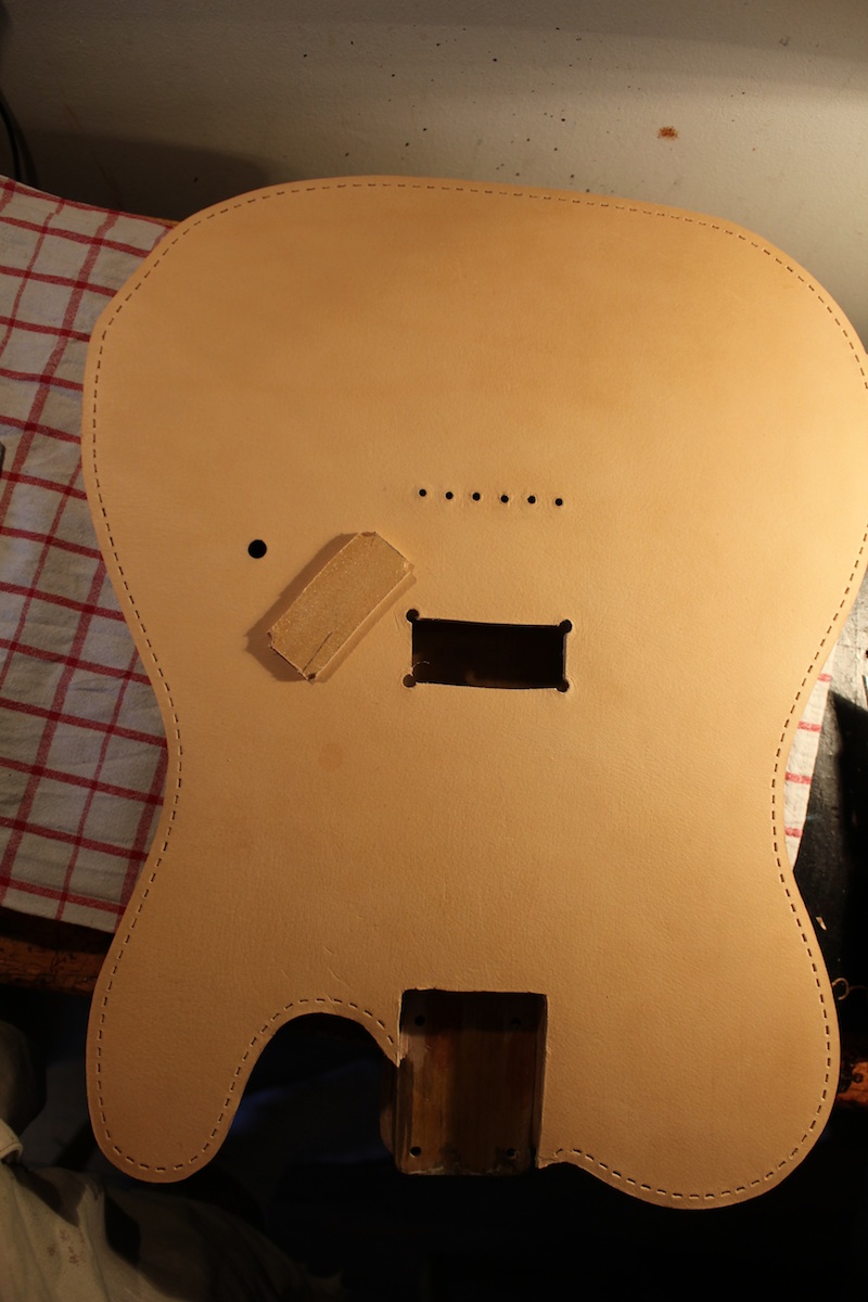

OK LETS CUT OUT THE NECK POCKET and PICKUP HOLE.
Materials and tools needed:
1. Razor Knife
2. Wood Burner with round tip.
STEP 8: Neck Pocket cut out.
A: Using the holes you previously punched; cut out a triangle wedge.
B: Cut closer to the edges so you can see what you are about to cut to the edges.
C: Very carefully eyeball your corners and edges with the knife. Leaving enough for the sides to join the pointed small corners for the outsides of the neck pocket. I left myself 5mm.
Step 9: Pickup Hole Cut Out
A: The same as the neck pocket cut on the insides of your pre-punched holes; just so you can see inside of the pickup hole.
B: Starting 1/2 way between the corners angle your cut to the edge of the perimeter and start cutting around lining up your edges perfectly. Make sure your blade is flat with the inside of the routed out pickup hole.
C: Using a wood burner I follow the edge of the leather and corners to make sure my edges are perfect and any loose leather fibers are dressed.
*****I also give the same treatment to the neck pocket that has been cut out.

STEP 8
A: With a wood burner I even out the edges of the Pick Up cut out and Neck pocket cut out.
B: Using Black Dye/Stain I black out the Pick Up Hole and Neck Pocket.

STEP 10:
A: Glue down the sides.
I use a high grade contact cement for this just as I did the top and back leather pieces.
I start with the neck Pocket Joint. Then work my way down to the end.
Follow the edges and pinch them together to stick.
**THIS CONCLUDES THE BASIC HOW TO COVER A GUITAR IN LEATHER**
