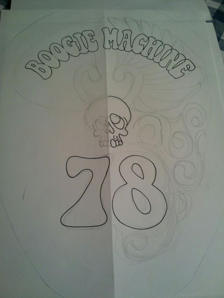

Members KurseD Posted March 5, 2013 Members Report Posted March 5, 2013 Well, this will be a long ongoing thread. Figured I would post progress here and keep you up to date with my learning curve as I'm sure this will probably turn into "First three attempts at the same seat" before it's all said and done. Cut the leather, then started doodling. Trying to keep with a 60s/70s concert poster style. Quote

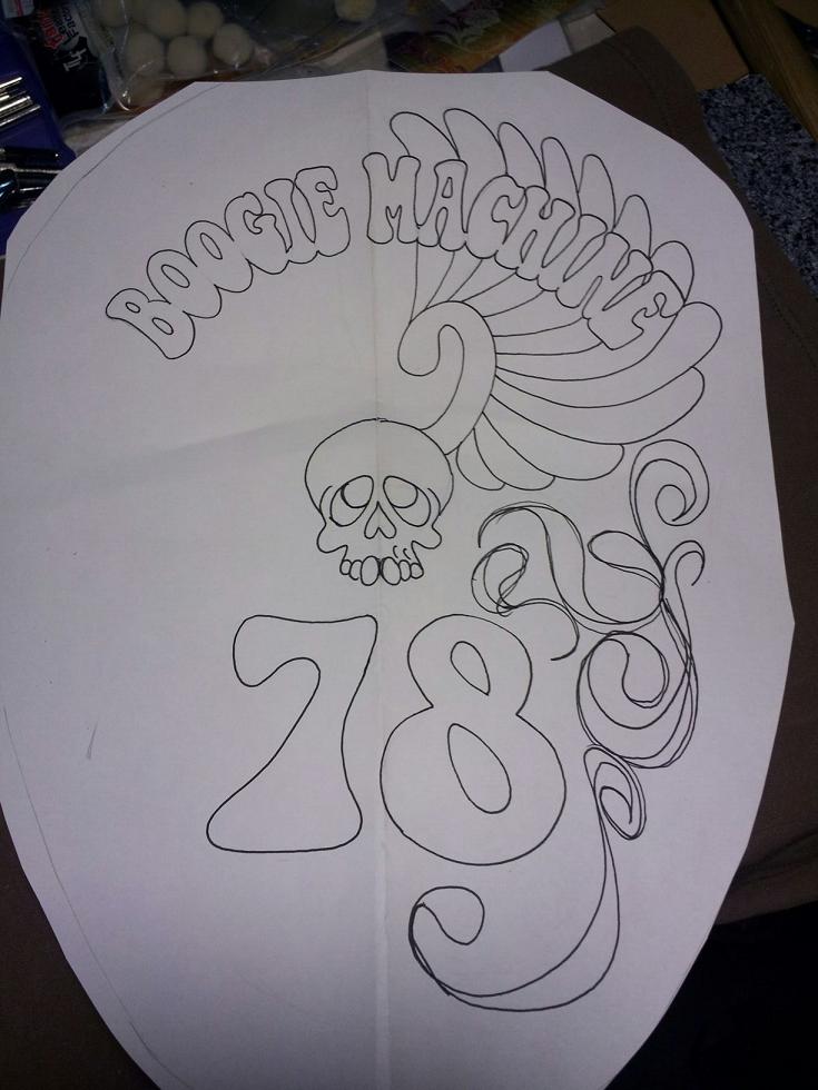

Members KurseD Posted March 10, 2013 Author Members Report Posted March 10, 2013 (edited) Finally got my "lightbox" going. Well, the lid to it anyway. Used the picture frame and two under cabinet floursecent fixtures from the home hardware shop. So finished the artwork and on to the leather work. I'm getting some "folding" or "wrinkling" around some of the tight edges when cutting as seen in the pictures. Also having a hard time with tool marks from the small beveler I'm using. Not sure what I'm doing wrong with either of those areas. Feel free to chime in with suggestions. Here's what I've got so far. Final design Starting the cutting Wrinkling around the tight edges Tool marks Edited March 10, 2013 by KurseD Quote
Members Cyberthrasher Posted March 10, 2013 Members Report Posted March 10, 2013 For your cutting, make sure that knife is stropped well and possibly wait a couple minutes longer before cutting. That can also happen if you're not keeping your knife perpendicular to the leather. Happens to me sometimes too, nothing that can't be fixed by rounding off the edge with a modeling spoon. If you don't have one, get one. It's one of the most important tools on your bench. We all start with tool marks - even when we think we're doing everything right. Make sure you're walking the beveler like a jack hammer or tattoo needle. You should be holding it just barely inside your cutline (or above it if you're comfortable there) and let the beveler bounce back up after you tap it down by using your finger as a shock absorber. The beveler should be doing the work. It should also be taptaptaptap with the mallet, not TAP......TAP.......TAP. If you can't get it all the way down without hitting too hard, make a second, or even third pass. Take a look at this video from Standing Bears. He does a good job at showing how to hold the beveler and walk it. Listen to the speed of his tapping too and notice that he goes back over the work instead of trying to compress the full depth in one blow. This video was actually the AHA!! moment that got me heading in the right direction at first. Quote
