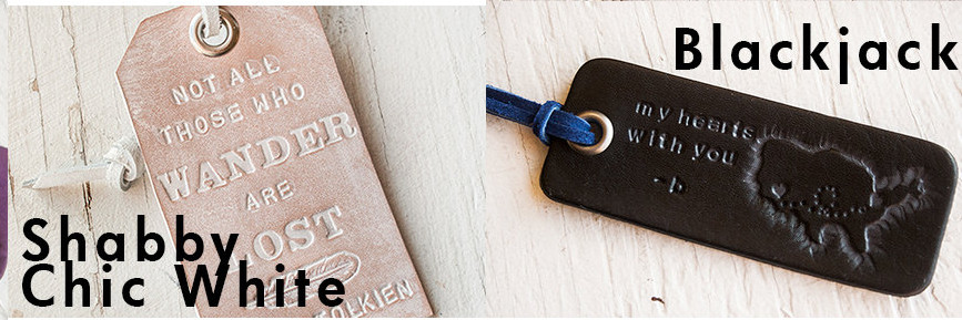

Members Sarah C Posted March 12, 2013 Members Report Posted March 12, 2013 Any help would be appreciated. I have yet to be able to make my tooling pop out in black finish applications like in "blackjack." And I was just curious about the white coloring. I was going to purchase a few different stains to try them out but honestly I am on a very tight budget and would like some help in identifying them before I buy a bunch of stuff and it's not right. Quote

Members Sarah C Posted March 22, 2013 Author Members Report Posted March 22, 2013 Thanks, but that thread was about removing the white haze from black dye applications. I am sort of asking the opposite! The tooling seems to pop out with a gray sort of color rather than a pure black color... and I want that. I emailed the shop owner (it's on etsy) but no luck yet. It looks like the rest of her color palette is simply the eco-flo high liters, so I'm assuming this one probably doesn't have much of an extensive "process" per se. And I love the white finish, I'm thinking maybe it's just some watered down cova color, since I can't find any kind of white "dye" that is eco-friendly (both her shop and mine are eco-friendly). Thank you for trying, though! Quote
Members David8386 Posted March 22, 2013 Members Report Posted March 22, 2013 Not sure about the black but it looks like the white is just white acrylic paint watered down and not wiped off well so that it shows the leather through in places but fills the lettering. David Quote

Members ReneeCanady Posted March 23, 2013 Members Report Posted March 23, 2013 (edited) Well my 2 cents here would be that the "blackjack" was already predyed leather when it was bought. I only use veg tan, but I did get some kind of grey leather for Christmas the year I got all my tools and played with it for about 2 seconds before I realized I liked the veg tan much better. With that being said, when I tried tooling the grey leather I got it didn't work so well because not only is it predyed or but it also has a slight finish on it. The finish almost makes casing the leather impossible. If you can't case it the tooling will not pop like it should and when I used the beveler with much more force than I would have to with a peice of veg tan it gave the same look at the photo for "blackjack". Almost as if the color you are calling white is actually what the inner part of the predyed black leather looks like (like when I hit the grey leather it was lighter in the area that was beveled naturally). One other reason that makes me think this is because the beveling on "blackjack" is rough. You shouldn't see all the tool marks like that...meaning I think they hit it pretty hard to make the impressions. Again this is all my opinion, I can't be certain. Edited March 23, 2013 by ReneeCanady Quote
Members Sarah C Posted March 23, 2013 Author Members Report Posted March 23, 2013 Thanks, everyone! I am not certain the black is predyed, only because that's how hard this person does all her tooling. You can see it in the rest of the items in her shop, all her beveling is like that. And it's obvious it's a practice piece shape (because I use those too, lol. they're perfect!), and I don't think those come pre-dyed anywhere that I'm aware of. I wonder if it isn't some watered down cova color to highlight the cuts and then wiped off (i.e. the white being used as a sort of high liter), before the black is dyed on, so it creates a sort of resist? I just hate wasting leather, maybe i'll find some scraps to try it out on! I'm sure I have something here I can use... I emailed the shop owner a while ago. I hope she answers me and it's not a "trade secret" or anything!!!!! Quote
Members Sarah C Posted March 23, 2013 Author Members Report Posted March 23, 2013 I also just had a thought... what if the leather was dyed first, and then tooled? Renee, you said you got impressions like that from a pre-dyed leather, maybe she dyed it herself first and then tooled it? I bet that would give those results! *runs off to try stuff* Quote
Members ReneeCanady Posted March 23, 2013 Members Report Posted March 23, 2013 Maybe you are on to something there! Quote
Leela Valley Leather Posted March 24, 2013 Report Posted March 24, 2013 It is possible that there is no other colour there other than black, we may just be seeing reflected light as the white in the lettering looks like reflected light to me. Quote
Members whiteeugene Posted March 25, 2013 Members Report Posted March 25, 2013 I wonder if they finished it then used some kind of a resist maybe two or three cotes let that dry and came back and wiped it with acrylic paint the paint would stall in the low spots and would wipe off of the flat spots I have used this to fill in letters as lone as you let the resist dry good the paint will not stick you can wipe it of with a damp cloth. Doug Quote
