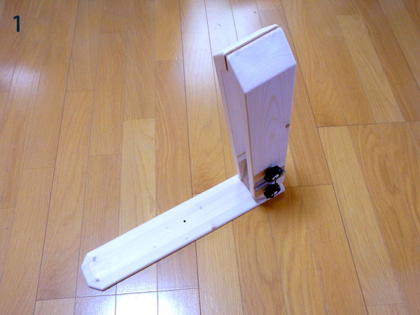

Unless you build one for you needs. I have built a couple of 'couch' stitching ponies. I am attaching a couple of photographs for you.
http://farm1.static.flickr.com/160/373211629_47c45ae8cb.jpg
My favorite and still in use....
http://blog.artifactbags.com/wp-content/gallery/stitching-horse-vs-stitching-clam/antique-stitching-clam.jpg
and of course, to help you understand how they are made.....minus the language barrier....here is a short video
http://www.fineleatherworking.com/blog/making-a-sewing-clam/
Hope this helps.
