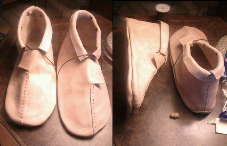

Members calanneh Posted September 4, 2008 Members Report Posted September 4, 2008 Hey folks! These are un-dyed as of yet. I plan to dye them black and I figured I would take a few pics now as some of the detail will be lost in the black when photos are taken later. These are a single piece 'turn shoe' style. I layed out a basic pattern I found on the net, made a big paper and masking tape version, then slit it where you see the seams and then traced it onto the 4-5oz veg tan leather. The toe and side were sewn by hand while inside out, then turned right side out, hence the name, turn-shoe. Then stitched the middle seam up the vamp and then the heel. I was going for a boot that would go part way up the thigh, but had a few 'enginerring issues'. I cut them down to ankle boots and I am really pleased with the way they came out. I am already making a second pair out of distressed upholstrey hide with the skin side out. I have a belt pouch I made last year and it has aged wonderfully. The distressed leather looks very very nice after a little use. I will post a pic of them when they are ready. Enjoy the pic and let me know what yall think please!!! cal Quote William Tandy Store #17 800-772-2629 Union City, CA
TomSwede Posted September 4, 2008 Report Posted September 4, 2008 Viking shoes oh yeah! They look very cool What did you use for a sole, rawwhide? I think (I think) that is quite common amongst ren-fair people here. Tom Quote Confucius - Better a diamond with a flaw than a pebble without. --------------------------------------------- www.1eye1.se blogg.1eye1.se
Members calanneh Posted September 4, 2008 Author Members Report Posted September 4, 2008 (edited) Thanks Tom!! I have ancestors I have traced back to Ireland, Finland, Norway and Greenland so the 'wild Northman" blood is in my veins...heheh I dont have a sole on the outside as of yet. I have worn them as they are (with padded insoles inside) and they are quite comfortable, but a little slippery. I will most likey take another piece of vegtan and glue it to the outside with the flesh side down. I did this with a pair of moccasins I made and it worked well. cal Edited September 4, 2008 by calanneh Quote William Tandy Store #17 800-772-2629 Union City, CA

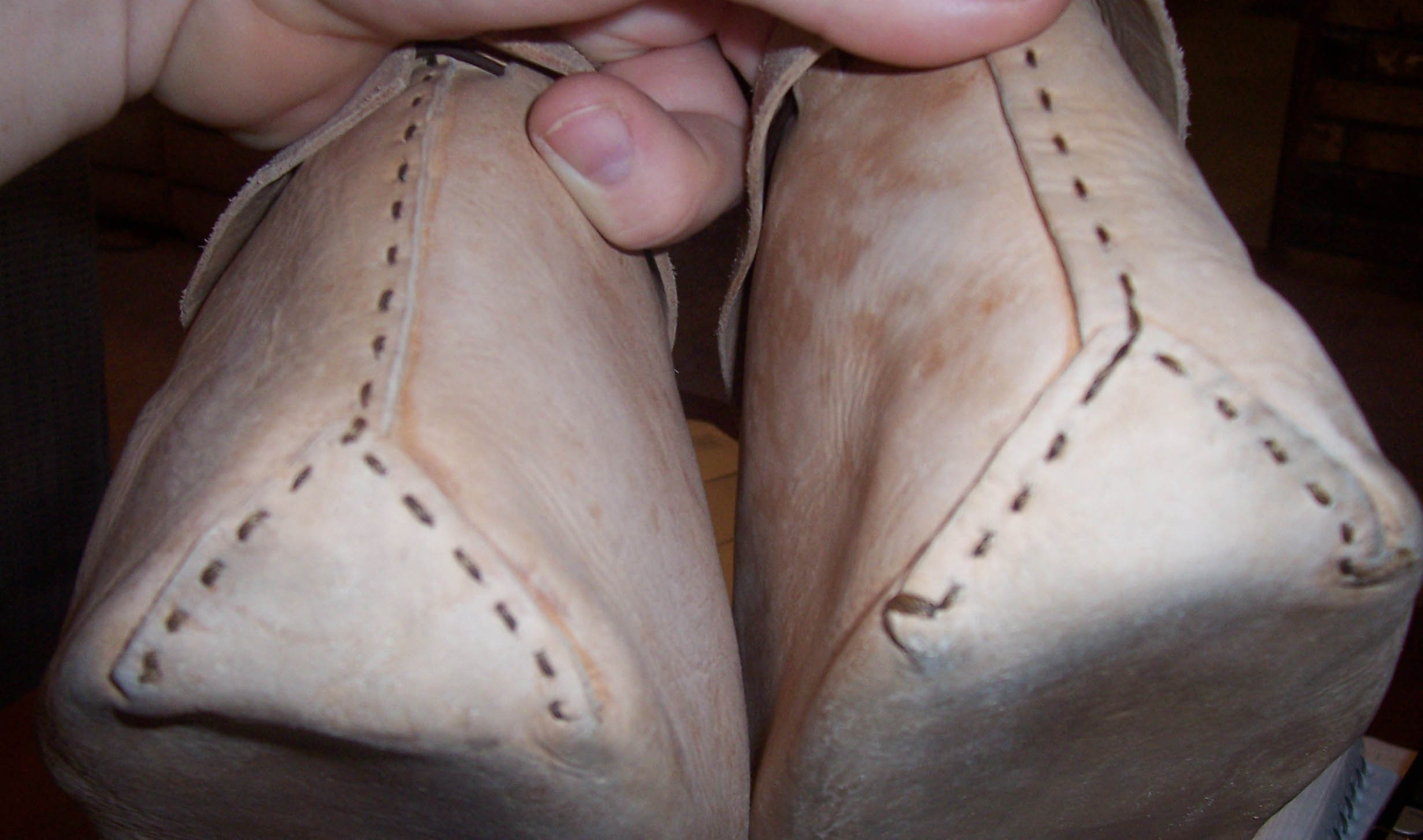

Members Daggrim Posted September 4, 2008 Members Report Posted September 4, 2008 Very nice boots. I've been making turnshoes, too, including the Jorvic boot. The heel looks well done...for me a very difficult area to perfect. I'll post a few pics later. I'd like to see a shot of your heel and sole sometime, if you don't mind. I'm still trying to perfect my techniques. You glued an outsole on a pair? Shoe Goo? I've heard Barge recommended, but I just haven't been able to believe it'd bond tough enough. I've sold a few Hedeby (?) style turnshoes at RenFaires recently, and plan to grow into this market. Not with the Viking boots, though...way harder to make. The two piece uppers don't demand the near perfection as the one part uppers. Thanks for the post. Daggrim Quote
Members calanneh Posted September 4, 2008 Author Members Report Posted September 4, 2008 (edited) Thanks Dag!! You're right, the heels can be a pain. Especially when you are using a stiff leather like vegtan. I rub them down a few times wiht Lexoll to help soften and lossen them up a little. It helps. Below are a few heel shots. I simpley folded the back side pieces over each other, stitched them, then folded the heel 'triangle' up as high as it would reach, stitched the top tip of it to the back to hold it all in place and then stitched up and down the triangle sides. I included an inside shot for that it's worth. One thing i had to engineer on the fly was the sides. The outside seams stuck out a bit far, so I wet-formed the sides to draw them in a good bit. On the side view below, the stitchign stops were my thumb is. The crease after that is all wetforming to get teh shape of the shoe right. I have not added the outer soles yet. I plan to use the normal 'contact cement' that Tandy sells. I have some rolled toggles made of the same vegtan I will put on after the boots are dyed black. The toggles will stay tan for a bit of contrast. Thanks for all your great comments and questions!!!! Ask away as it makes me thing of ways to tweak the next pair!! cal Edited September 4, 2008 by calanneh Quote William Tandy Store #17 800-772-2629 Union City, CA
