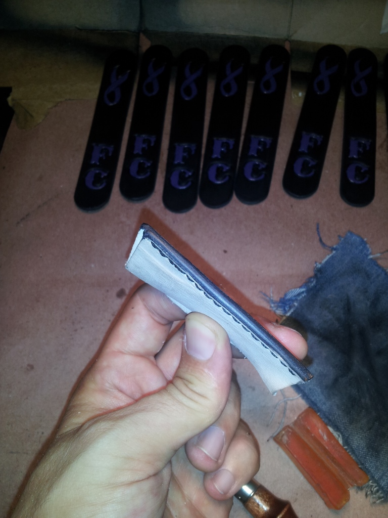

Members Eternal Custom Designs Posted June 20, 2013 Author Members Report Posted June 20, 2013 Cool...I just posted progress pics on fb...cause all my files seem to be to large...I'm about to go to my jobber now and grab some resolene...I used a block this morning with 320 and got the shape finish I like to see on the edges... ( no fuzzies)..how do u apply the resolene? And can I use the Aussie over the resolene...I like the smell and want to pass that as well on to my customers...I feel smell is a big plus... its a very subtle smell...it doesn't take away the natural leather smell at all...it just crisps it up a bit...kinda like the new car smell so to speak...if u can pls check out my pics on fb and tell me your thoughts!!! Quote

Members Eternal Custom Designs Posted June 20, 2013 Author Members Report Posted June 20, 2013 Awesome awesome awesome... yeah I do other custom stuff on the side like custom paint on cars...and test panels are a must...after the three coats do I buff it before the aussie with my wool pads? Also when I apply my Aussie I'm going to burnish the edges again...I'll let you know if that makes a difference...detail detail detail!!! Quote
