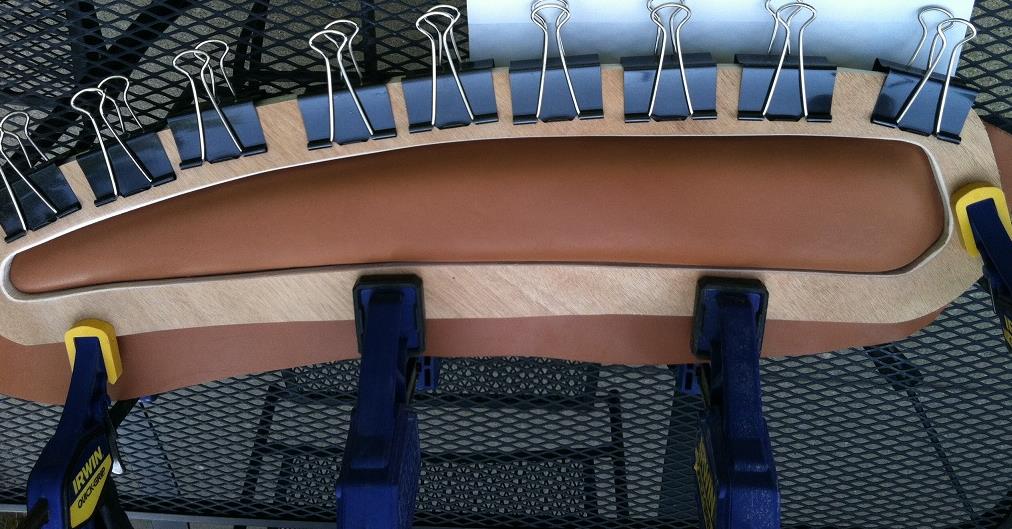

Members chriscraft Posted July 20, 2013 Members Report Posted July 20, 2013 After hours of searching and coming up empty. I decided to make my own bicycle Leather Tank using wet formed 8-9oz HO. This one i'm currently building is for a customer. So It starts out as a hardwood maple form as I'm also using it to do my tooling on. This right side will get a drop down door for storage. Quote

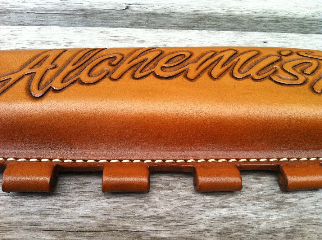

Members chriscraft Posted July 20, 2013 Author Members Report Posted July 20, 2013 The customer chose the name that is tooled on this leather tank. I just used my freehand style script lettering that I've developed over the years to make it even more unique. I made a built in leather hinge using a round metal rod and after some time sanding and burnishing, it now swings open nicely. Quote
Members chriscraft Posted July 20, 2013 Author Members Report Posted July 20, 2013 (edited) The other side (left) will not get a hinged drop down door. The tops of these both sides will have three leather straps that will buckle shut. When stitched once around the edge, everything will be sewn in place like the buckle straps and bottom door side hinge. I'll be using bonded 346 size thread with a 26 needle at 5 stitches per inch. Edited July 20, 2013 by chriscraft Quote
Members chriscraft Posted July 20, 2013 Author Members Report Posted July 20, 2013 This is where I ended up today. I used a Chestnut Tan highlight dye and after everything was dry I feathered the edges with pro oil dye. First I used a diluted Light Brown with a gravity fed Iwata airbrush. Then I hit the outer edges with Dark Brown as I want the light colored thread to stand out. I was in a hurry and didn't get to dye the straps and some other items. Will have to finish it off another day. I'm still new to this leatherwork but I'm satisfied with my results so far. Every time I work on a new project I feel I get better. Chris Quote
