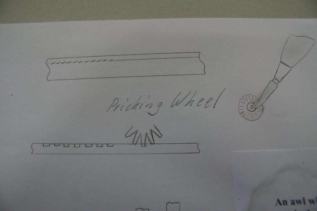

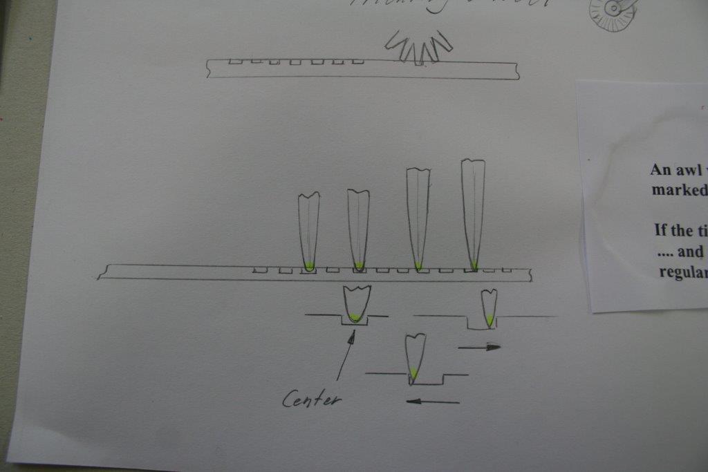

Hello Ledehandwerker ....
Here is something about tool.
Starting with the "Priks" as they say here in Switzerland, or in French - "Griffe à molette" .......... or English - "PrickingWheels"
The sizes of the wheels go down there 4-24 stitches per inch.
Where 24 is almost unnähbar.
In between, one can see "Priks" with so-called "blind Wheels" a certain fondness saddlery equal to the seam wanted to push something in leather with iron wheels.
Then the English "Prik" with the white button on top which was made from ox-bone on the reef.
A very rare specimen. Ic had in the 30 years seen only once, except of course my part here .... (((-:
Full linkis are still 3 tools with which the saddler stirrer most marked for a rough total on a simp decoration like bells belts for cows. Let it be just easier to sell with a bit of decoration .... ((-:
More tomorrow, mene rough waiting, we go to the "Pig Roast"
As they say here in the fall when the farmers slaughter the pigs and then they cook pig-roasting sausages, blood sausages and meat with sauerkraut boiler. etc.
greeting
Walter
