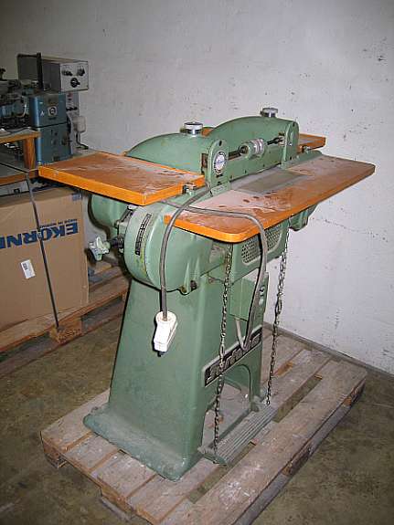

Hello friends, I missed this one http://www.ebay.ca/i...3#ht_421wt_1162 somebody got them self a very nice Mayer Flamery Parer. It had to be a quick sale,
Is it not the same as one of yours Walter?
Hey Tor,
Another one has just gone up on Ebay.fr
http://www.ebay.fr/itm/OUTIL-ANCIEN-MACHINE-a-PARER-de-BOURRELIER-CORDONNIER-CUIR-LEATHER-SHAVE-/290984308870?pt=FR_JG_Art_Objets_XIX&hash=item43c0043086

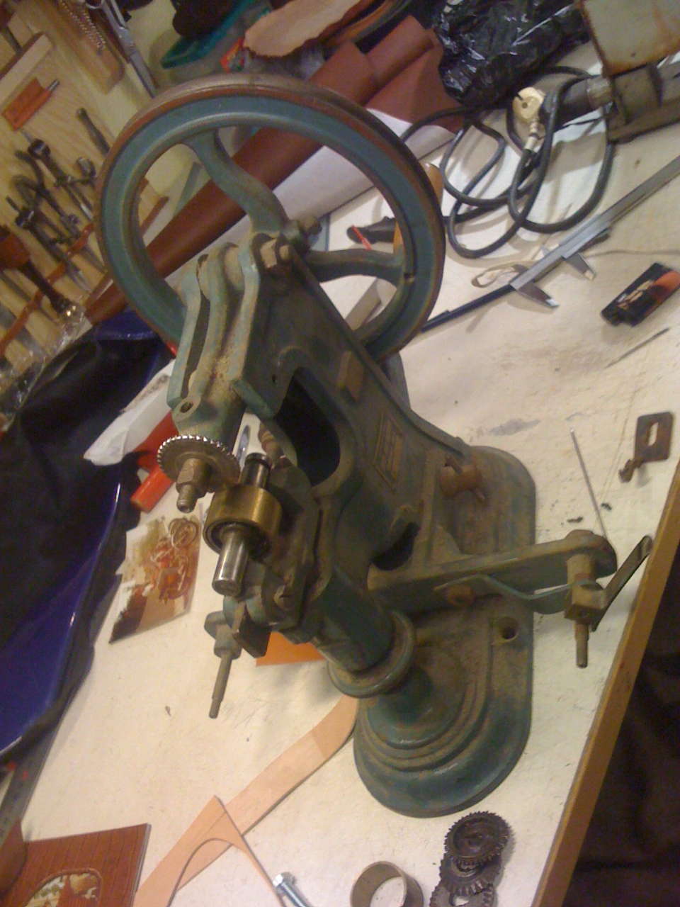

Thank you Macca, this one starts high. Today I did a very good buy on a Fortuna band knife splitter, a big box with allot of clicking dies (shoe related mostly), A very nice little United shoe machine pinking machine with many tools (bench machine, it can be used as an embosser too) several rolls of leather and vinyl etc. On the purchase the seller gave me an old Adler class 5-25 head for free. It was stuck, I used an half hour and half a liter diesel (lamp oil) and now it turns, it looks good too. A bit rust inside, it will come off. I do not want to tell you the price yet, I can tell you it was very... very cheap. I think this will be my best one so far, because the band knife machine is normally priced very high. The old man who sold it to me could not use any of his stuff anymore and was happy to get rid of it. The machine works very well. Its a machine just like this one ( but not this one), I will post a picture of it later when I have it in my shop. I have to get this one in my shop before I buy any more, I am completely stuffed. Thanks for telling me, I will see how high it goes.
Here is a picture of that pinking machine, it is some more option on it you can put a V belt on it and its a pulley on a shaft behind machine too ( you do not see it on this pic). I also found a small nice stove for heating finishing tools (like creasers and such)
It needs some cleaning up of course.

A good Plough is more efficient to use such a large Riemenschneidmaschiene.
To get forward more quickly with the work and it needs little power doing... If they are properly ground.
The large Riemenschneider by Müller and Kurt, I long ago time sold, so a machine seemed to be useless.
http://www.sieck.de/Maschinen/riemen-schneiden/details/Mueller-Kurth-Typ-37-n-riemenschneide-reifel-und-praegemaschine-generalueberholt/
