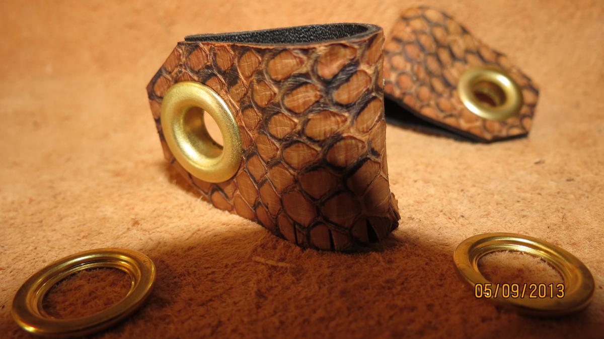

Members bone42 Posted August 25, 2013 Author Members Report Posted August 25, 2013 Here's one I didn't dye. Quote
Members bone42 Posted September 11, 2013 Author Members Report Posted September 11, 2013 (edited) Sorry just noticed the pic didn't upload off my mobile.. Here they are. Edited September 11, 2013 by bone42 Quote
