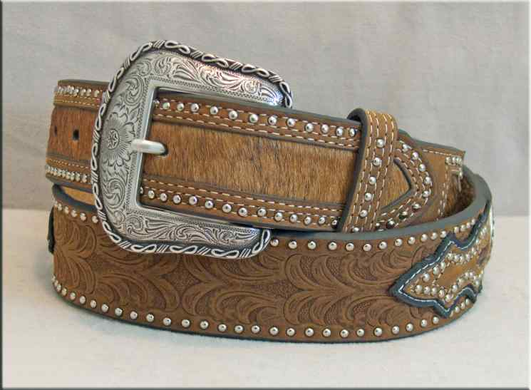

If you bought the hair on straps from Tandy that they are currently selling, My personal opinion for what it is worth is that they are not heavy enough to use as belts themselves. If i were going to use them as belts I would laminate them onto a leather strip at least 5-6oz. Then treat the way you would any other belt blank.
I was thinking of getting some however I would cut them into smaller pieces and use them as inlays like the attached picture. However I prefer to use calf as it is shorter and seems to shed less.
This is not expertise just my opinion based on my experience.

Yeah, I live pretty far from the nearest Tandy, so I ordered them online, and was thinking pretty much the same thing when they showed up in the mail. Guess I should've waited 'til I could go and see them in person! Live and learn!
I have one person who wants it as is, so I guess I'll forge ahead and try it anyway. The worst that can happen, I guess, is that it doesn't work out! But the inlay looks pretty cool, so I'll have to try it that way, too.
