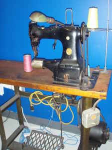

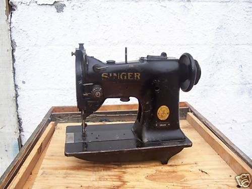

Here are some pictures of machines that I'm looking at. Do any of them look worthwhile?
1) Singer 15-90
2) Not sure, but priced right:
3) 2 PLATES ON THIS READ 8368 & 8369
4) ???
5) looks kinda small
Thanks for helping me out here!

# 4 looks like a leather sewing machine. Art is the resident guru and I think he will be able to give you great info.
Thanks, Jordan! I think you're probably right about #4. I'm hoping that my requirements are such that I don't necessarily need a leather sewing machine. I just need a machine that will sew leather. (Yes, I realize that makes no sense :wacko: )
Schno - Los Angeles, CA

Hi Schno,
I don't like to turn anyone onto a used machine who is clueless because there are all kinds of pitfalls. However, within your constraints, No 4 ???? which is a Singer 153 would be a good choice if it is in good condition and the right model, like a 153W103, and the price is right, $300 or so. The cylinder arm is always a plus. The one pictured is a oooolder model. For your money, Artisan makes a little machine that is very economical, can't think of the number right now, but it is the same basic machine that Sailrite and others use, but Artisan service comes with it, which is great, and it is more or less fitted for leatherwork, which the others are not. The machine is very portable yet can sew substantial thickness pretty well. Call them about it.
Art
