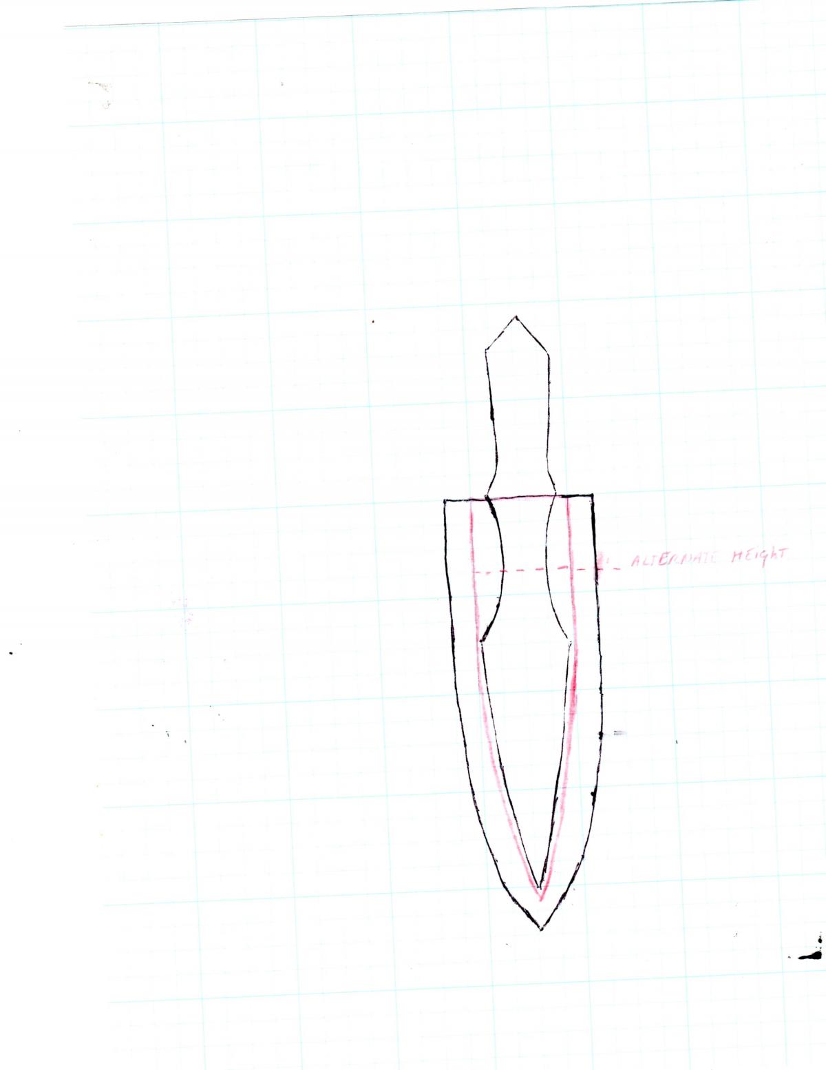

I woould make a simple sheath cut the front and back the same cut a welt attach a belt clip to one side do tooling if any dye glue stitch and finish edges you have a boot knife. Here is a rough drawing should print out pretty close to actual size and give you something to work from. Because the knife sits fairly deep it should be secure yet present enough of the tang to draw the knife easily. The red dotted line is an alternate height for the sheath.

That's what I was thinking, that's a good idea. Maybe pop a few rivets along the sides there to lace through, depending on how it would be worn. I appreciate it man! Any other thoughts would be awesome, too!
