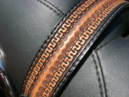

Members roadking07 Posted October 9, 2008 Members Report Posted October 9, 2008 This is a seat strap that Steve B did for his harley (www.steveb.biz) - he has a great style and I love his work. What steps are taken in order to get this finish with the black in the background and the natural color on the high points? Thank you Quote MDH Leatherworks Blog "You can't fake quality anymore than you can fake a good meal." -William S. Burroughs
tashabear Posted October 9, 2008 Report Posted October 9, 2008 Looks like an antiquing stain to me. Quote
Members craftsman827 Posted October 10, 2008 Members Report Posted October 10, 2008 Roadking, That effect is done with antique finish. Paul Burnette has a how to book Midas Majic, & it shows all the techniques. 1. stamp 2. dye tan 3. dye border Dk. brown 4.after dry, use leather balm w/ atom wax, to seal the dye 5, antique with med. brown 6. seal with aclilic resoline Thats about all I can remember. Hope it helps Quote
Contributing Member ClayB Posted October 10, 2008 Contributing Member Report Posted October 10, 2008 There are probably several different ways you could achieve something close to this look. Another option would be to use something like the Sheridan style finsihing technique. Oil with pure neatsfoot oil, let dry to even out. Then when that's dry, you would probably dye the edges the dark color. Apply Neatlac (or some other resist) and let dry. Apply antique to bring out the impressions. Apply a finish. Quote ClayB Badlands Leather Art blog Badlands Leather Art Website
Members roadking07 Posted October 10, 2008 Author Members Report Posted October 10, 2008 Thanks for the input everybody - I will try this finish on my next project. Quote MDH Leatherworks Blog "You can't fake quality anymore than you can fake a good meal." -William S. Burroughs
Members whinewine Posted October 10, 2008 Members Report Posted October 10, 2008 ClayB said: There are probably several different ways you could achieve something close to this look. Another option would be to use something like the Sheridan style finsihing technique. Oil with pure neatsfoot oil, let dry to even out. Then when that's dry, you would probably dye the edges the dark color. Apply Neatlac (or some other resist) and let dry. Apply antique to bring out the impressions. Apply a finish. And possibly airbrush the edges, also. russ Quote
