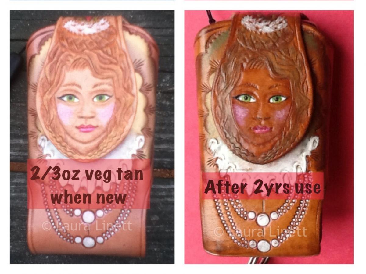

Toolingaround Report post Posted March 18, 2014 Hi There I know I posted this picture yesterday in another discussion but it seemed kind of relevant. This is my personal cell phone case I have worn on my hip for at least two years and shows what time alone can do. It has turned into that reddish color. My t shirt is usually over my phone so she has not really had that much sun exposure. I oiled it with Lexol NF which is non darkening and you can see that in her face which is the original leather color but over the years she has gone from a pale red head to a lovely African American color. I hope that doesn't sound racist. I used to do figure painting and truly appreciate all the beautiful skin tones we as humans come in. I will be curious to see how your tests go :-) On an opposite note what finishes do others use to reduce the darkening if they don't want that to happen. I have heard resolene mentioned. Any others? Cheers, Toolingaround Quote Share this post Link to post Share on other sites
rpfkov Report post Posted March 18, 2014 Hi There I know I posted this picture yesterday in another discussion but it seemed kind of relevant. This is my personal cell phone case I have worn on my hip for at least two years and shows what time alone can do. It has turned into that reddish color. My t shirt is usually over my phone so she has not really had that much sun exposure. I oiled it with Lexol NF which is non darkening and you can see that in her face which is the original leather color but over the years she has gone from a pale red head to a lovely African American color. I hope that doesn't sound racist. I used to do figure painting and truly appreciate all the beautiful skin tones we as humans come in. I will be curious to see how your tests go :-) On an opposite note what finishes do others use to reduce the darkening if they don't want that to happen. I have heard resolene mentioned. Any others? Cheers, Toolingaround Hi, Thanks very much for posting your photos, they are indeed very relavent indeed to what I am asking. It's clear I can get the colour I want, it will just take time and patience. Quote Share this post Link to post Share on other sites
