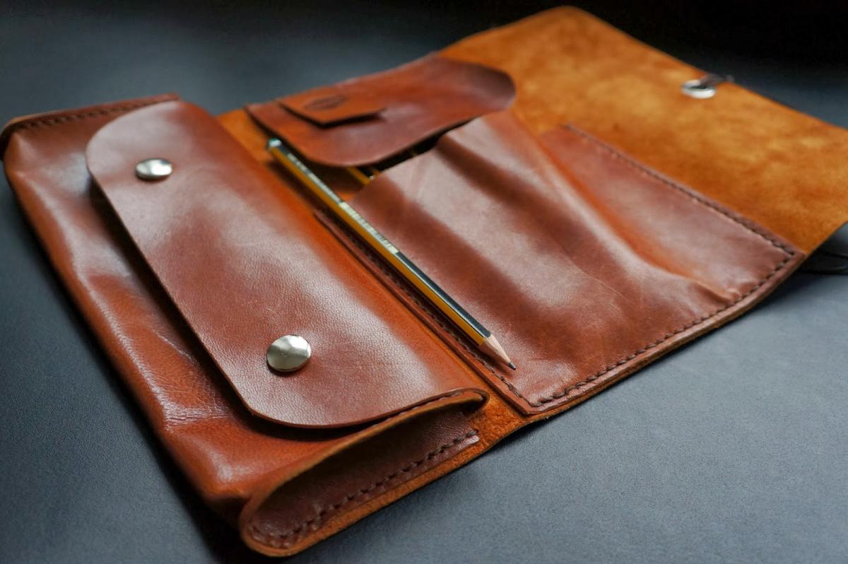

Attached is what I'm making hand stitched but it just takes way too long.
This is sheep leather and from what I've seen trying out various walking foot machines it gets marked up really bad, calf leather as well so no good for appearances!
I think I've slowly realised that doing this on a machine, it'll look different, the gussets for a start are too small I'd imagine even for a cylinder arm. So those will be made differently. To mask up the teeth marks in the leather I'm thinking I can finish it with edge binding/bias binding (I don't even know what it's called!)all around the edge in a waxed canvas of some sort.

Hopefully what you'll be seeing now is a copy I've taken from the blog which is low res..... deep breathe!
post-31994-0-47051800-1396568361_thumb.j

A pfaff 335 would be the best of the bunch for this. A flat bed can sew this but you would have to sew it with the needle going in from the inside gusset out and since the bottom will never look as good as the top, it won't look as good as if you sewed it from the outside in. Hence the cylinder bed. I don't know exactly what leather you are using but if it's very soft then what I mentioned may be less of an issue.
The leather in the picture doesn't look terribly firm so feet marks may not be a problem if you use smooth presser feet.

Yes this is a really soft sheep leather, it marks up with the slightest look at a finger nail! Smooth pressor feet I guess are a must for it or use a different leather, are non-veg tanned leathers more resistant to machine presoor feet marks, I've only used veg tanned leather for hand stitching.
