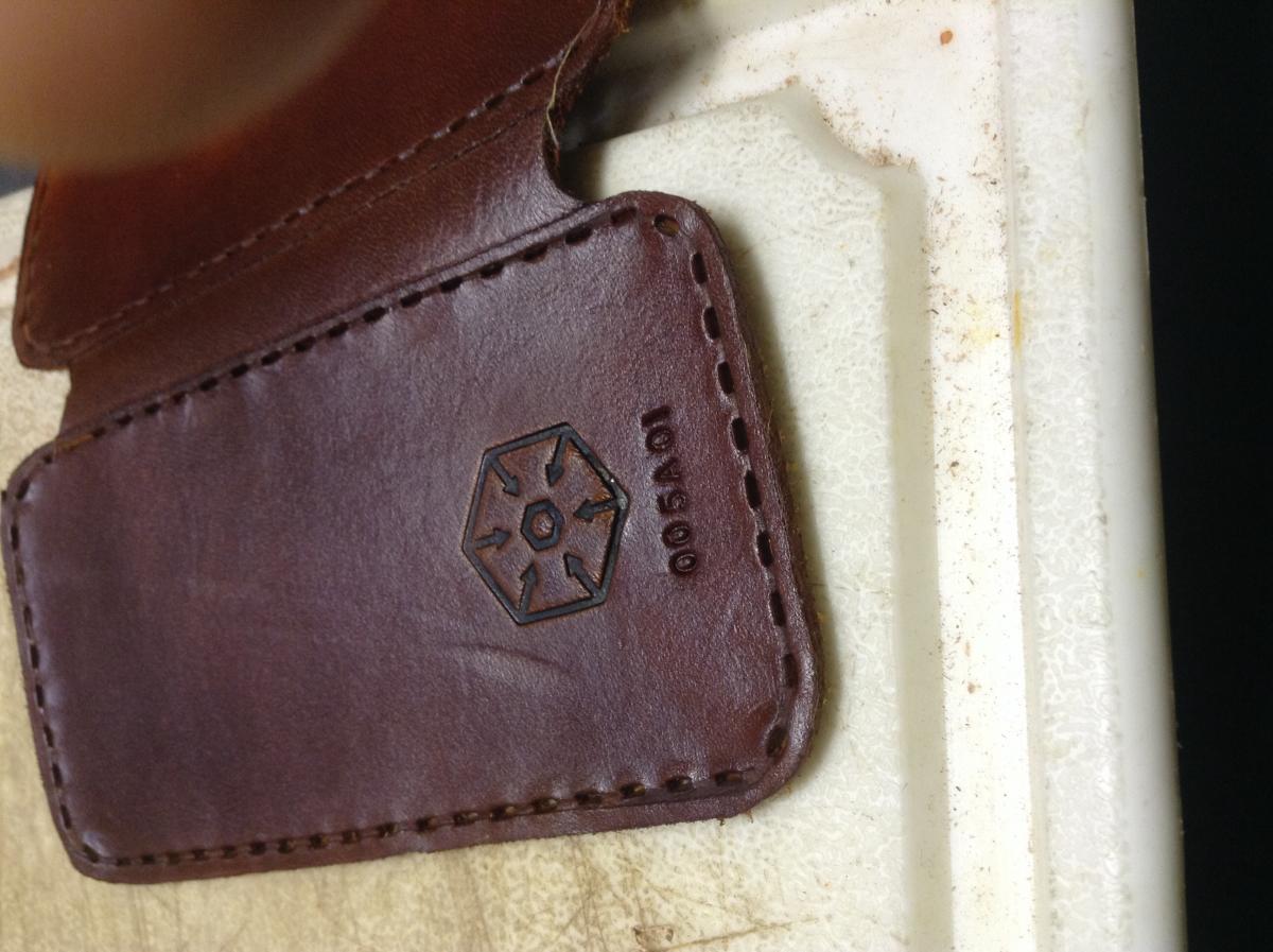

Members bethefawn Posted July 30, 2014 Members Report Posted July 30, 2014 Just got my brand/hot stamp from shapeways.com today, I think it cost me more than the six bucks the tutorial mentions (primarily because I needed it a little big to capture the detail), but I'm pretty happy with it! It may not be a proper maker's mark, and I'm worried it's a little big for wallets, but it works pretty well (I've used it subsequently on other pieces to the one pictured, and it looks a lot nicer). Of course, now I want an arbor press instead of mashing it down with my 25 lb dumbbell! Quote
