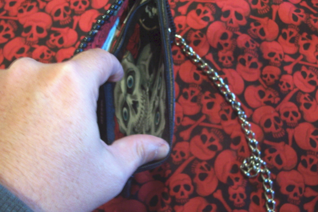

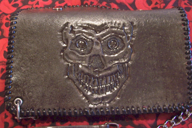

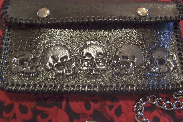

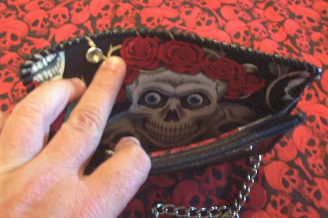

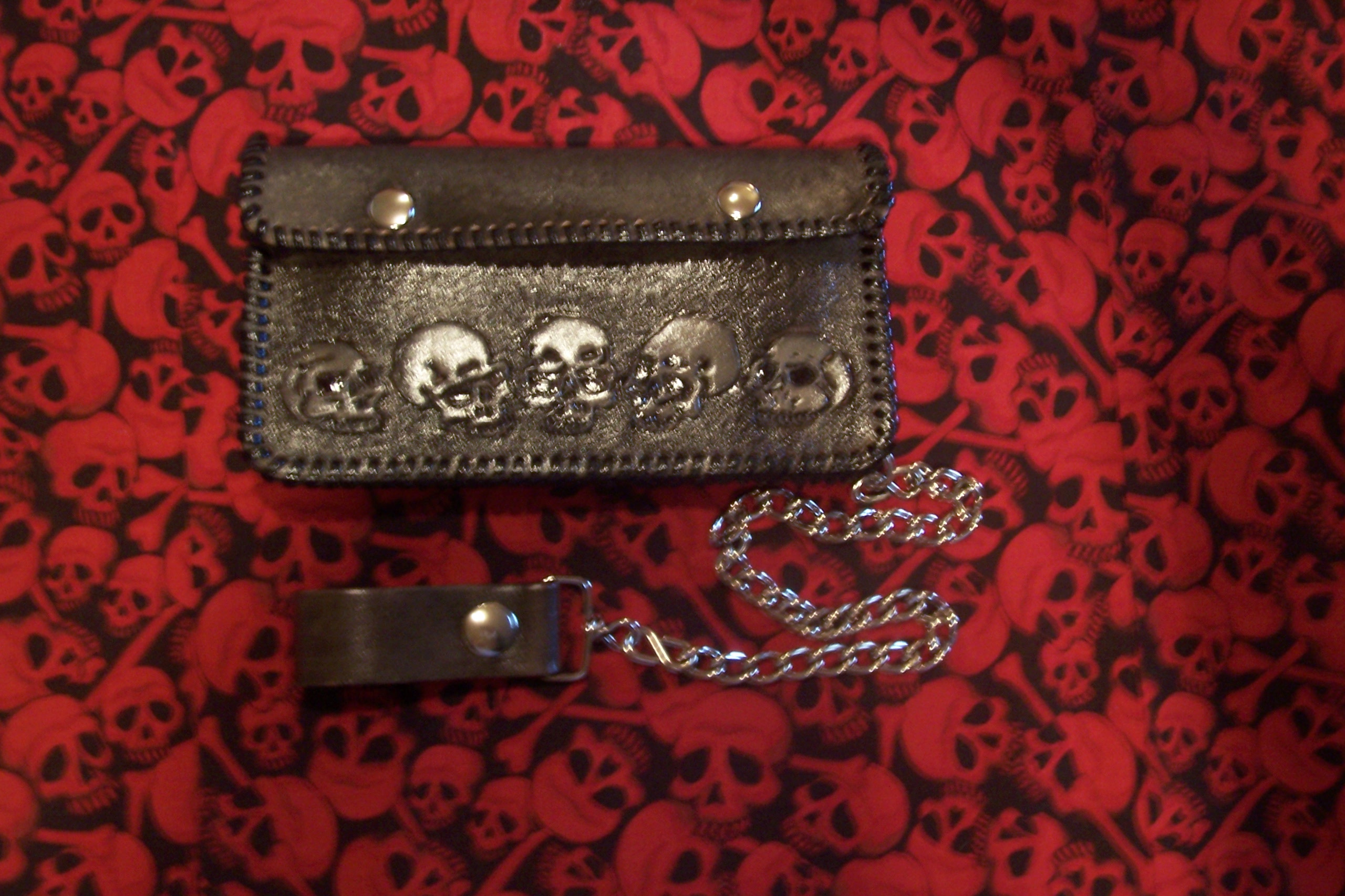

OK, here is a picture of the Tandy Biker wallet kit I just finished. I had posted a question about liners in the How you do that folder. But I ran with scissors and did it my way ;)Alright, the kit was done pretty much like it was intended, however since I did the liner I used a whip stitch and had to hand sew a stiffener to hold the top of the liner on the back cash pocket. It wasn't until I was finished that I realize that I used the blue eye skull dude so much. The only part not lined is the "bellows internal pocket that makes up the two sides.It was finished using the Eco-Flo smoke black stain. It has a fresh coat of leather sheen that I hope will dull some as the idea was to make it look a bit worn. I have never carried such a wallet, man it is thick! I doubt I could ever wear it out though....I don't know how long it takes folks who do this for money, but I'd be headed "fo tha poe hawse" in a hurry if I was making these to sell! LOL!Anyway enjoy. Please let me know what you think.

Dude, very nice tooling. You have GOT to learn lacing though. It's not hard, even a monkey like me can handle it. I always dreaded it & when I first started figured I'd never do it. All it takes is time. For rank beginners (like me), I like the tandy book pictured here:
http://www.tandyleatherfactory.com/product...number=61906-00
It's very visually oriented and not hard to follow. Each step, start to finish is clearly illustrated, including splicing, starts & stops, joining, etc. IMHO, it's the best for learning to lace. I still leave it open in front of me while lacing.
A nice double loop would have dressed that up a bit. Still, not a bad looking result. Liner's cool too. Good luck on the lacing!
