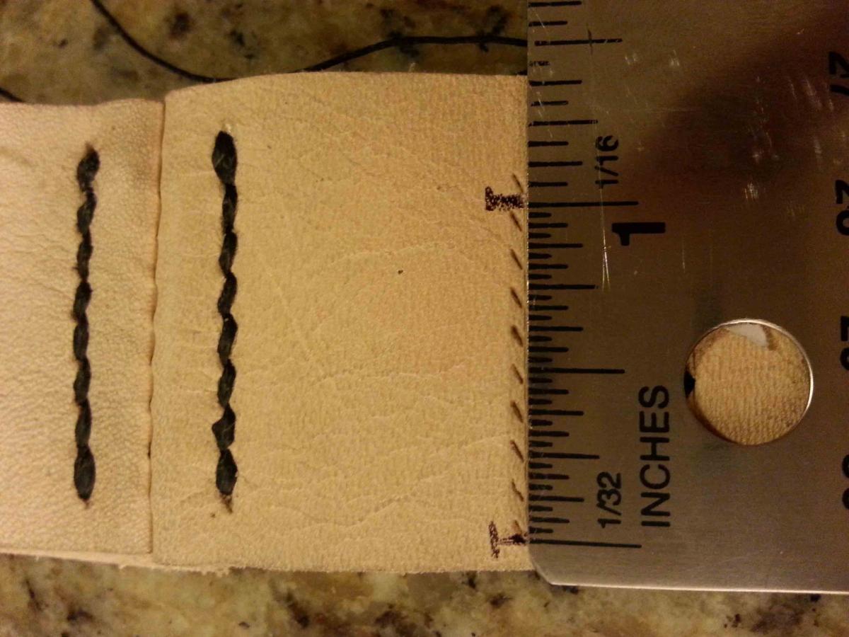

Members Oldtoolsniper Posted December 10, 2014 Members Report Posted December 10, 2014 When I measure the Blanchard number 9 It gives me 9 Teeth per inch and 8 stitches, my number 7 dixon gives me 7 stitches. Anyone else get the same thing? I posted the pictures to clear up the confusion. My apologies, I assumed seven holes meant seven stitches. Seven holes makes six stitches. Perhaps DavidL can post pictures showing us his so we can see the difference between Dixons and Blanchards. I think that would make this a very helpful post for everyone looking at pricking irons in the future.. Quote
Members Hi Im Joe Posted December 10, 2014 Members Report Posted December 10, 2014 I posted the pictures to clear up the confusion. My apologies, I assumed seven holes meant seven stitches. Seven holes makes six stitches. Perhaps DavidL can post pictures showing us his so we can see the difference between Dixons and Blanchards. I think that would make this a very helpful post for everyone looking at pricking irons in the future.. See though what Macca was saying was correct. For that iron to give you seven stitches per inch it should have 8 prongs to an inch. It does not appear that way to me from the pictures. Quote
Members Oldtoolsniper Posted December 10, 2014 Members Report Posted December 10, 2014 See though what Macca was saying was correct. For that iron to give you seven stitches per inch it should have 8 prongs to an inch. It does not appear that way to me from the pictures. There are only seven prongs to the inch on my Blanchard 7 8 iron. So on Blanchard made irons everything is counted by the prongs not the stitches. I trust DavidL can post pictures of his tools so we can see. If I understand this correctly Blanchard counts prongs per inch and everyone else counts stitch per inch. Quote

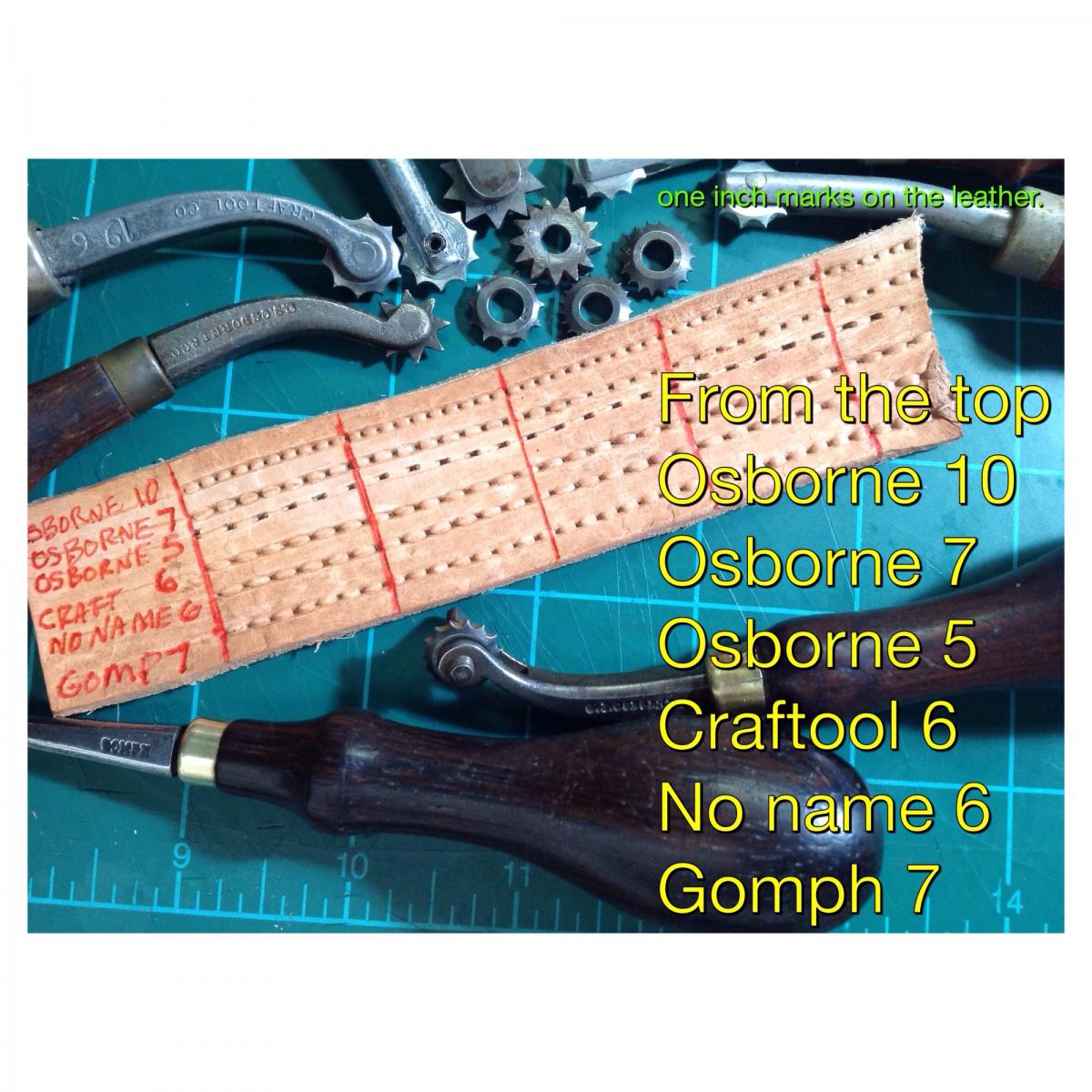

Members Oldtoolsniper Posted December 10, 2014 Members Report Posted December 10, 2014 (edited) To further make this clear as mud. I have quite a pile of tools so I did a test run on some marking and overstitch wheels. I did a few inches so it can be seen that they are close at best. I think it's a fair representation of what's out there and how they line up. I know this is getting a little out there from what the OP was asking but there is a lot of good information being discussed and I think most folks start with these wheels for marking out stitches. The first mark starts in the red line on the left side of the picture. Edited December 10, 2014 by Oldtoolsniper Quote
Members Grey Drakkon Posted December 10, 2014 Author Members Report Posted December 10, 2014 I'm happy to be getting such a great discussion! I love seeing physical comparisons like that, so thanks. Quote

Members MonicaJacobson Posted December 12, 2014 Members Report Posted December 12, 2014 I'm still not convinced tpi and spi is a big enough difference to matter. You guys had me all rattled when I bought my 8spi blanchard thinking it would give me roughly 7spi. When I measure the stitches, there are exactly 8 per inch. Good, I guess? Mine give me 8 stitches, or basically 8 1/2 slits. Quote
Members Oldtoolsniper Posted December 12, 2014 Members Report Posted December 12, 2014 This has been a very informative thread. I'm thinking at this point as long as it looks good and is done properly a stitch up or down really makes no difference. I can't imagine it makes much difference strength wise. Now let's get the thread size and awl sizes worked out and this will be a phenomenal thread. Quote
Members DavidL Posted December 12, 2014 Members Report Posted December 12, 2014 Mines nearly identical the holes are smaller on mine as its a Number 9. There are 9 Slits though in my 9 iron (9 teeth per inch) which makes it 8SPI. The stitches are angled so it becomes very close to 9 SPI, I guess because there are gaps in-between the stitching shortening the stitch length. The end results is 9SPI Im still not sure if they are TPI or SPI Officially, I'll send an email and see what they say. Quote
