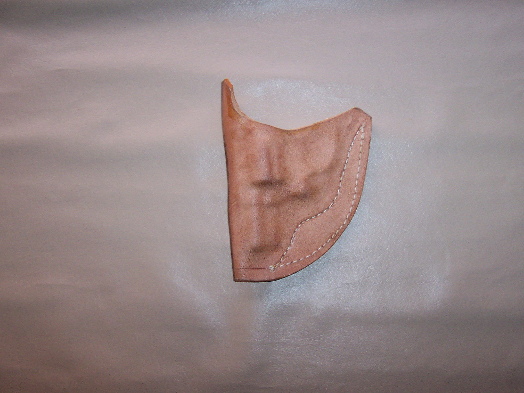

Randyc Posted January 23, 2008 Report Posted January 23, 2008 I designed and built this holster for a co-workers Smith & Wesson J Frame Revolver. The holster was made from 7-8 oz. vegtan cowhide. The holster was built with hooks on both sides of the throat then glued and stitched rough side out to aid in pocket retention. The holster was pressed, hand molded, and finished in tan kote. Randy Quote Randy Cooley Bulldog Custom Gun Leather www.bulldogleathercompany.com
Members jt1 Posted January 24, 2008 Members Report Posted January 24, 2008 Randy, NIce job, looks like it will stay put when the gun is drawn, this is of course the most important thing for a pocket holster. The rough out is a good idea for pocket carry. As Always jt Quote As Always jt
Randyc Posted January 24, 2008 Author Report Posted January 24, 2008 JT, Thanks for the kind words. I depend on you guys for feedback and critique. It really helps with my R&D. Randy Quote Randy Cooley Bulldog Custom Gun Leather www.bulldogleathercompany.com

Members DavidII Posted December 8, 2008 Members Report Posted December 8, 2008 I designed and built this holster for a co-workers Smith & Wesson J Frame Revolver. The holster was made from 7-8 oz. vegtan cowhide. The holster was built with hooks on both sides of the throat then glued and stitched rough side out to aid in pocket retention. The holster was pressed, hand molded, and finished in tan kote.Randy Can someone describe what the "hooks" are on this type of holster? Thanks, David Quote
Randyc Posted December 8, 2008 Author Report Posted December 8, 2008 Dave, Hi, I'm the guy who made that pocket holster. When I first saw your post, I thought cool, someone besides me builds pocket holsters. I clicked on the thread and there was one of my holsters from an eariler post. The hook is a leather extension that aids in keeping the holster in the pocket while drawing the weapon. The hook is designed to grab a corner of the pocket while drawing the weapon. That particular holster has a hook just above the hammer area and another hook just above the trigger guard. Randy Quote Randy Cooley Bulldog Custom Gun Leather www.bulldogleathercompany.com
Members Shorts Posted December 9, 2008 Members Report Posted December 9, 2008 Good stuff Randy. I've never tried my hand at pocket holsters - there are others who can do them much better than I - Nice work What is tan kote? Tan Kote is a clear gloss finish Quote
Members Rayban Posted November 2, 2011 Members Report Posted November 2, 2011 I've been playing around to come up with the "perfect" pocket holster for my 442....I decided this one is it (so far)......I tried the "hooks" and didn't care for them much so thought I could see if I could do without them. This one works out well. I figure the gun doesn't have to fit the holster very tightly......just enough to orient the gun in my pocket like I want, and know where the grip is at when I reach in for it. There's just enough hook at the trigger guard area to aid a bit, but I don't really need it. This one is done in horsehide. Quote Raybanwww.rgleather.net
