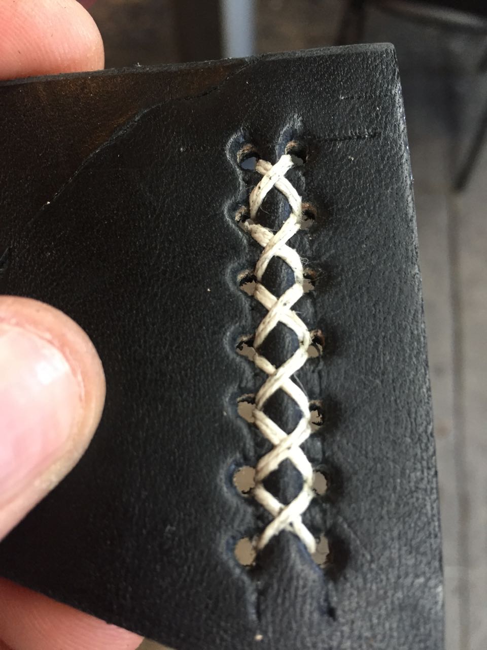

Hi, thanks so much for the feedback.
I did as suggested, but without the overhand knot behind each cross. I finished it with a surgeon's knot. The one on top has holes made with a 2mm hole punch and the lower one with a stitching awl and twisted around.
post-62665-0-93985600-1433356484_thumb.j
post-62665-0-46102400-1433356493_thumb.j
Not really, I think it works alright when I hammer down the knot. I will try a star stitch next to see how they compare and then upload a photo.
