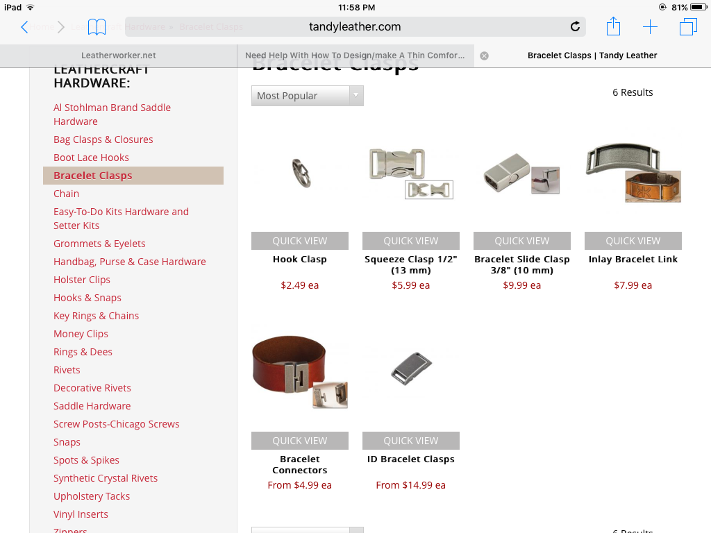

I have had great luck with the bracelet connector. The way I use it, I make the bracelet the same width as the connector. I cut a notch on each corner to allow a tab to slide into the connector. Makes for a smooth look and it is quite comfortable.
