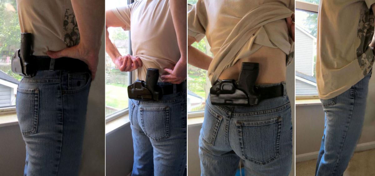

I hate the new Galco SoB holsters, so I went back and recreated the original horizontal Galco design except with a bunch of improvements over the original that make it safer and more reliable.
The picture is of my wife with one of my SoB holsters and her M&P Shield.

the question I have about the above is, if being drawn with the right hand is there a problem with sweeping in the wrong direction? someone made one for me prior to my desire to start making them on my own and it was made with the gun right side up. Other than the fact that the person who made it did it as cheaply as possible it was a well thought out design.
When drawn with the right hand, it sweeps down toward the floor. The gun being upside down is not only for the correct draw and sweep, but the center of gravity is right on the belt so it doesn't hang or stick out. With a correctly fitting belt, the grip should lean in toward your back and not lean out.
