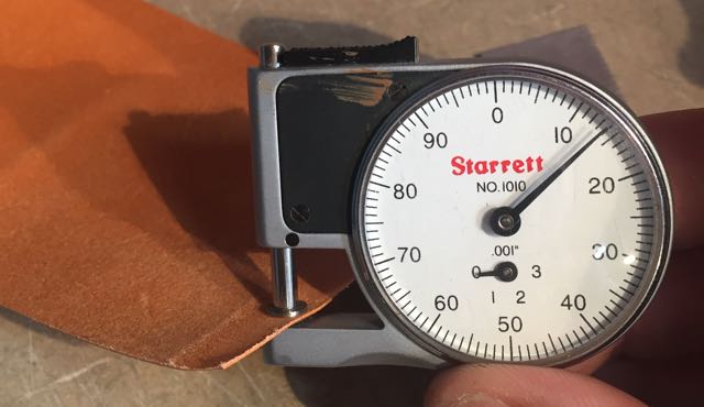

Nuttish Report post Posted March 18, 2016 The rolled edges are labor intensive for sure, but they give a look not possible otherwise. I actually like doing them. My powered skiver doesn't do well with already thin leather so I use one of my round knives with the leather on a piece of fairly thick glass and skive by hand. Have gotten fairly fast at it. ferg The wallet was made right side out. It's too small to turn inside out without damaging the leather and stitches. The edges were skived on a machine, glued, rolled, glued together, then stitched. The curves are challenging, but the process is the same as an outside curved hem on clothing, where you remove notches of material just behind your folding line. Ferg, FWIW, a Fortuna should be able to skive thin leather to a paper thin edge suitable for rolling. My knife is very sharp and I use a roller foot nearly touching the feed roll. This is ~2 oz W&C English bridle skived to ~1 oz. Quote Share this post Link to post Share on other sites

dasc8079 Report post Posted March 19, 2016 The wallet was made right side out. It's too small to turn inside out without damaging the leather and stitches. The edges were skived on a machine, glued, rolled, glued together, then stitched. The curves are challenging, but the process is the same as an outside curved hem on clothing, where you remove notches of material just behind your folding line. Ferg, FWIW, a Fortuna should be able to skive thin leather to a paper thin edge suitable for rolling. My knife is very sharp and I use a roller foot nearly touching the feed roll. This is ~2 oz W&C English bridle skived to ~1 oz. IMG_0671.jpg IMG_0672.jpg Thanks! The rolled edges look so amazing I think I'm going to give it a try. I think they are worth the extra effort. Quote Share this post Link to post Share on other sites
