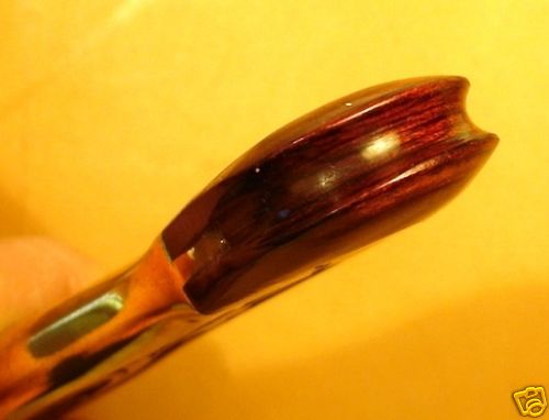

Take a look at this burnisher, wow. I thought I would share it with you all.

Weaver sells that one. I wish its catalog would have shown those same angles.
What kind of a woodworking tool would one need to carve that kind of a groove? Router? I was thinking of cutting off about 3" of some turning stock and doing something similar.

Hi Ed: My guess would be that was done with a series of rattail files. The original cut was done with a course file and was finished with either sandpaper or a jewelers round file which is much finer than the wood working one. Rattail files are a round file with the cutting edges completely around the file. They come in different diameters, especially the jewelers files.

Ed,
If you look close it appears that they started with a standard
slot cutting bit and then rounded it with as a previous poster
said with a file. One could use sandpaper wrapped around a
dowel if they were only going to make a few. You could come
close to the same design by doing like the cheap nylon one sold
by most leather supply stores. Take a simple round burnisher
cut in half then attach it to a fancy handle.If you wanted to
make it like this one you could turn a larger diameter burnisher
on a lathe then cut in half and then slice it down to the width
you want and using a file just follow the groove round to the
flat sides.and you will have the same thing they have. Of course
after reading what I just wrote it would probably be better if I had
drawn it out instead of trying to explain it in words.
