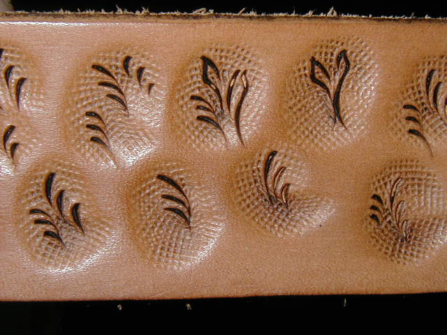

Here is a sample of the effect on a practice piece...
The small white spots were left to show what happens if bubbles are allowed to stay in the cuts...
but this shows the intermediate darkening effect of the crosshatched pear shader... still allowing the decorative cuts to be darker... and the non stamped area around the edge of the leaf or petal will be even lighter.. Greg

The outcome looks good to me. I did not tryed your method myself yet due to missing time. In fact, I'm also frightned that this procedure will take me nearly as long as the rest of the work in my pieces. Anyway, I need to try it
