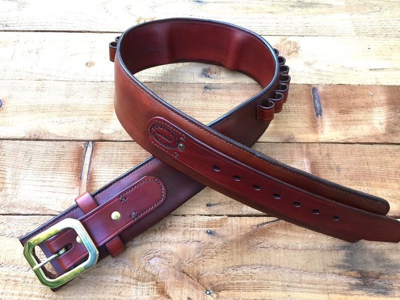

Thanks for your reply. Maybe I should add that it would be a cartridge belt for a .45 colt revolver, so it doesn‘t have to go through any loops. Width would be around 2-2.5inches. Sorry about that.
Edit: something like this is the goal: il_794xN.1185862144_4k85.jpg
