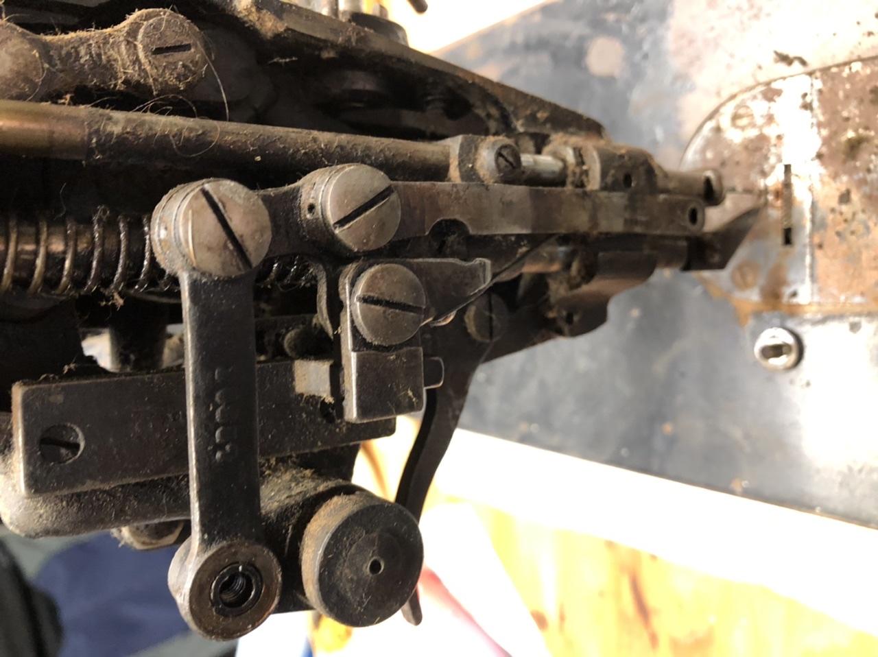

This is a Singer 44-79. I haven’t seen a shuttle similar to this. The machine here is in the position where the needle has lifted around 3mm so I assume the end of the shuttle that is at top dead center is what I’d time this off?

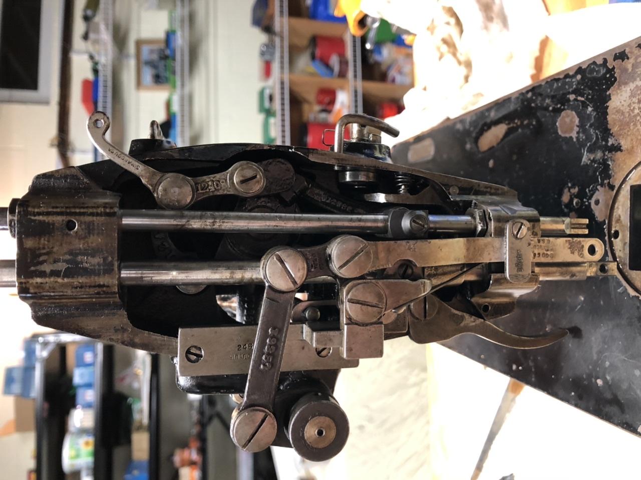

To the right is the housing business that faces the shuttle.

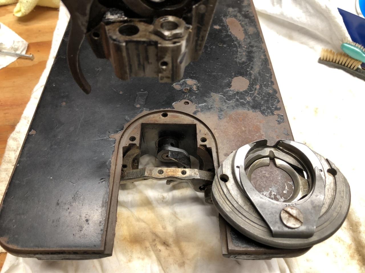

Shuttle race looks like a plain CB shuttle race. Noting unusual as far as I can tell from the backside of the race.
Im not 100% sure but the 44-79 seems to be a shorter version of the 31-19 so the timing values should be the same.
You can download a manual for the 31-19 here
Manual for Singer 31-19
