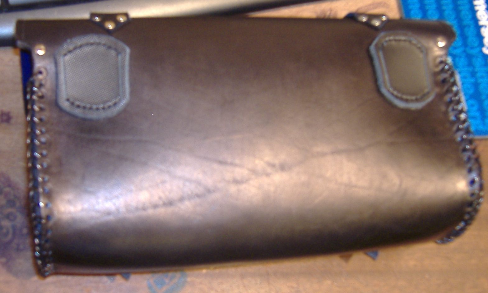

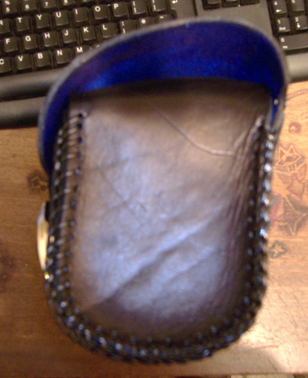

today is a new day and I am relatively happy with the results of my first lacing attempts (after a lot of playing, to get it right - i think).
here is the finished piece and the piece before rivet failure, i still like the rivets but the lacing looks fine too.
what do you think, I can't seem to get decent pics of my work, I need to learn how to use a camera.
Thanks everyone!

re: photography-> you need, IMSHO:
more light
a camera with a Macro adjustment
a tripod (or a mono pod like I favor in the shop)...
your shots are blurry and those three components should help
Your camera probably has an autofocus setting, make sure your giving it enough time to lock on,
especially in low light situations

as always YMMV - but i think youve got the train back on the tracks by the look of the case above
