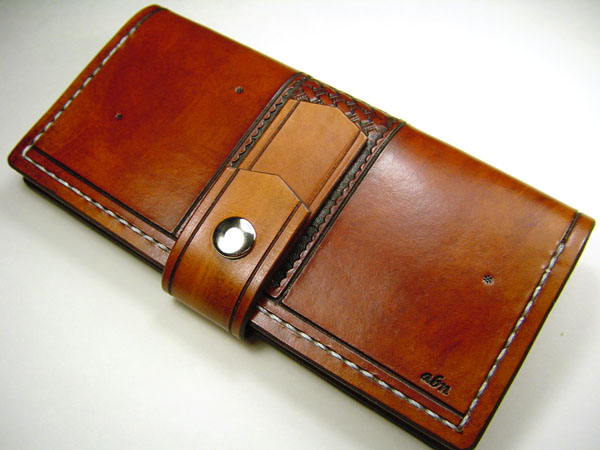

Looks like you put a bit of everything on that project! :) Plus, it sounds like you're poised to add Pecard's to the mix! You know, lots of folks have incredibly complex concoctions for dyeing and finishing, but it can be simple, too. Here's what I do, in order:
1. Apply a coat of Lexol to condition the leather, let dry 10 minutes, and then buff with a cotton rag. (I apply the Lexol first, because it can lift the Eco-Flo stains I use.)
2. Apply Tandy Eco-Flo All-In-One Stain and Finish, and immediately buff off the excess. Repeat if necessary, but gently -- the second coat can lift the first one and make a mess of your project. Let this dry a couple of hours.
3. Lightly -- very lightly -- apply three coats of Tandy's Satin Shene, letting each coat dry 10 minutes before applying the next. Finally, buff with a soft cotton rag.
In my experience, this leaves a nice, water-resistant color. I'm attaching a photo of a recent project done this way, using the Acorn Brown color.
Now, I'll be willing to bet that with 500+ members here, you could get 500+ opinions on the best way to apply a finish. But, as a beginner, I'd encourage you to pick one stain, and then a complementary conditioner and finish, and see what you can do with it. Always play around on scrap -- don't try something for the first time on a finished product, no matter how tempting.
Plus, try to educate yourself on the compatibility and the advantages/disadvantages of all these products. For example, mixing spirit dyes with water isn't optimal (as Don alluded to), and putting both acrylic and wax-based finishes on the same item may not be the best way to a good finish.
The good news is you're on the road to figuring this out by asking questions here. For more info, you can also buy and try products on scrap, and ask lots of questions at your local Tandy store.
Good luck! -Alex
