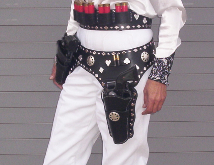

Members Jim Posted December 2, 2006 Members Report Posted December 2, 2006 Dave, A simple fix to a simple problem is to dye the outside of the wrist bands with two coats of Fiebing's Oil Dye and then seal them with Fiebing's Resolene. The photo shows a gun belt I made for a Lady in Fort Worth that was dyed and sealed in just such a way. Notice that she's wearing white denim jeans? Any rub off? Nuff said, have fun. Quote Never forget where you are, so you will always remember where you've been.
