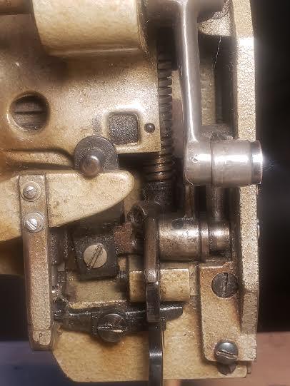

Hey everyone i am new to the group and just have a question. The feet i have on the table are the ones i use regularly and they do fine. I recently bought a different style and put them on. As you can see in the picture they will not reach any leather i put under it. How do i bring the foot down? I have a pfaff 145 and ive seen on singers their will be a set screw if you call it on the side that you can bring that bar down. Anyways any help would be greatly appreciated.
Thanks,
Matt Ferguson
Might as well get foot sets that match what you already have.  You won't want to make machine adjustments every time you change feet.
How do the new and old sets compare in length?
only like a quarter on a inch difference. I was just wanting to try different feet. the one I have on it had that bulge or whatever you call it at the bottom of it that gives it length. I believe the one that reaches the leather is called a welting foot.
