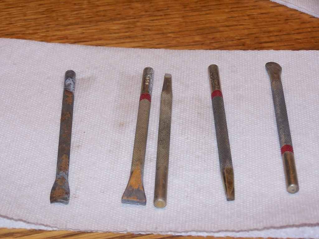

I felt like experimenting today. I'm attaching before and after photos of two of the suggested methods. I didn't have any of the chrome plated tools that needed cleaned, so I used the ones that were yucky to see what would happen.
The first picture is the before for the heated cream of tartar bath. The second is the after. It peeled off the corrosion, and the plating, and was probably starting to eat the metal. I got a funny feeling these are cast zinc tools with a dichromate finish rather than steel tools, so this may sway the results somewhat. The small nosed tool (topmost in the first pic) has a bright and shiny tip which is unscathed, but the rest of the tool is pitted. The others don't seem pitted, but no real improvement either.
The 3rd picture is the before for a vinegar bath, room temp. The second is the after. No real change for these. Again, the metallurgy may be an affector. One of the tools clearly shows a reddish (iron) oxide both before and after though.
Sometimes, I just have to try.
I'll rig up an electrolysis bath one of these days and give it a shot. What it will do to these funny yellow tools is anyones guess...

Ok, I am totally finished with the tools.... Along with the above mentioned method of cleaning the tooling heads of the tools, I then took everything over to the work bench and put the "brass" colored 8" wire wheel onto the grinder along with the cardboard buffing wheel I have been using from my buffing/sharpening kit. I used the wire wheel to clean all the shafts of the tools... on several there was a minute speck of rust on the shaft and when i hit it with the wire wheel it removed it along with the plating showing allot of rust beneath the plating. I was able to clean all this up and put then on the buffer using white compound and buffed the metal to a nice shine.... some of them (more vainers' than anything else) had under the plating rust all the way to the tip of the tooling head so I knocked it all off.... the metal was in good shape and buffed up nicely.... on a few the tools had been banged around where the tooling pattern was slightly messed up and I buffed them as well as I could and left them... I will keep them as they.... give them character I hope... all in all I only lost one tool in this whole thing and it was the very small pear shader that I tested the 8" wire wheel on and the wheel tool the tooling pattern off the head.... I smoothed it out and buffed it to a shine so i can use it as a smooth pear shader instead of a patterned one...
