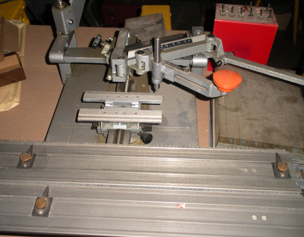

Check out this cool stuff I scored today - some guy gave me both machines and all the fonts and accessories. The first is a brass name-plate engraver - works great, but I forgot to pick up the drive belt, so couldn't engrave anything

Ian, those are two fine tools to have. With some imagination you do lots of things with those two items. Also a little practice maybe required too :))
