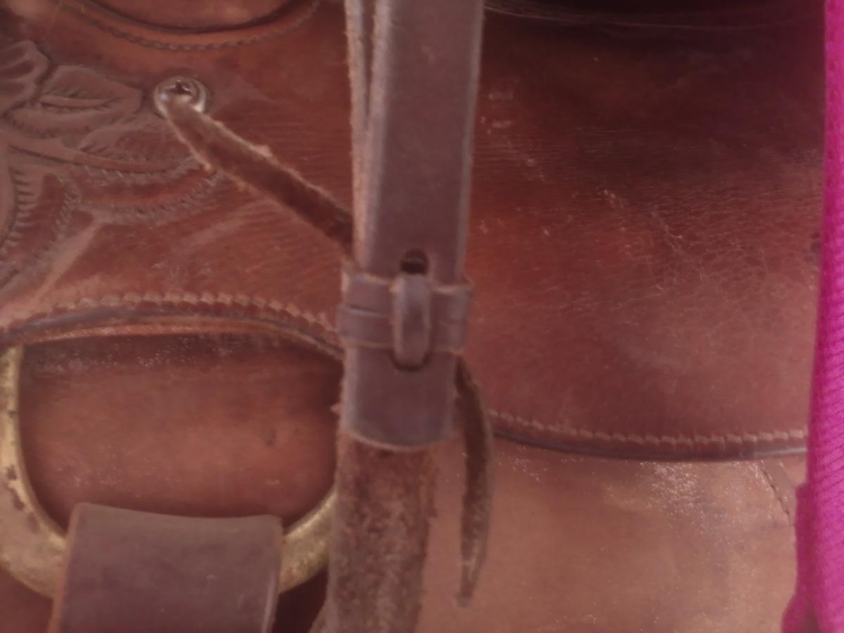

Here is the way I do it. Was taught to me by an older horseman who worked at a cutting horse ranch. Never comes untied and is not difficult to take out if you need to.
I tried to post photos but keep getting "low memory" error. I don't know what that is about as I reduce the camera setting to low as I could go. I'll try later as I have had no trouble posting photos in the past.
1 go through both holes from the back of the water loop and rein holes, leave a little loose. Take one lace and wrap around to the front and then back around to the back and pass under the loop and continue around to the front, pass under the lace and work until tight.
2 take the second end and repeat going the opposite direction.

That looks really nice! Thanks for sharing!

That is nifty sonorabitandspur! I've never seen anything like it before. Really cool, thanks so much for sharing!
