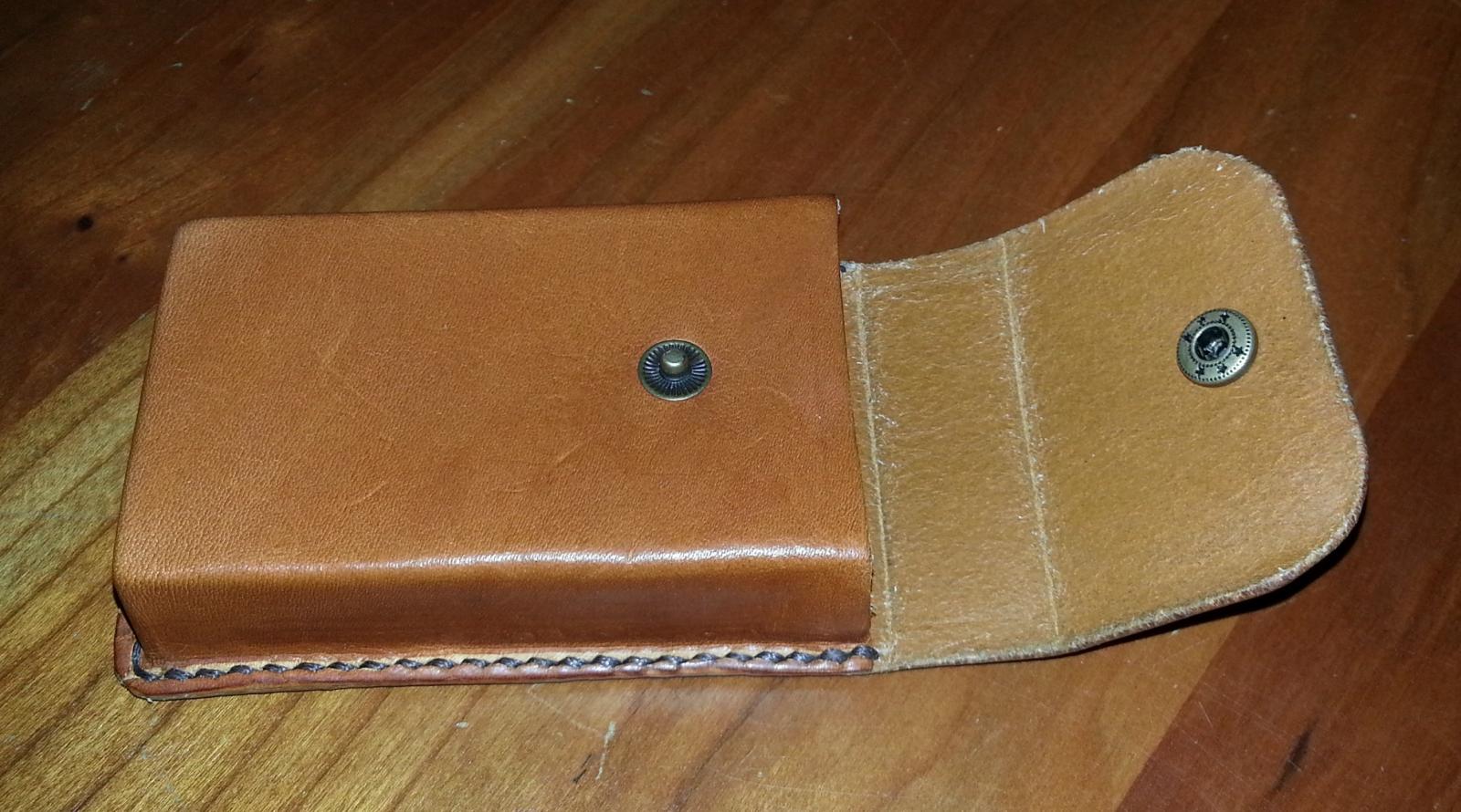

This is my first attempt at wet molding leather. It is a business card holder.
First Wet Mold Project

The first one is always rewarding. You start out with "I think I can do this", the progress to "I CAN do this!"
Bigfoote
Nice job for your first one! That sounds wrong, I meant it's a nice job, hard to believe it's your first one! My first one was crap! lol.
m1dizigan
Thank you for the kind words.
I've learned a great deal about the process by those who have shared their experiences so I need to give credit where credit is due.
I wet the chrome 2-3 oz leather in warm to hot water til all the bubbles stopped. My wife also gave me a set of bone shapers (creasers?) for a Christmas gift. They made the shaping process over the form much easier and I cut the leather to relieve an bunching. Once the shape was contoured, I  used some wood working spring clamps to hold the form in position. It was crude but effective. A second scrape block helped to keep the leather shape while using pricking irons and stitching.
