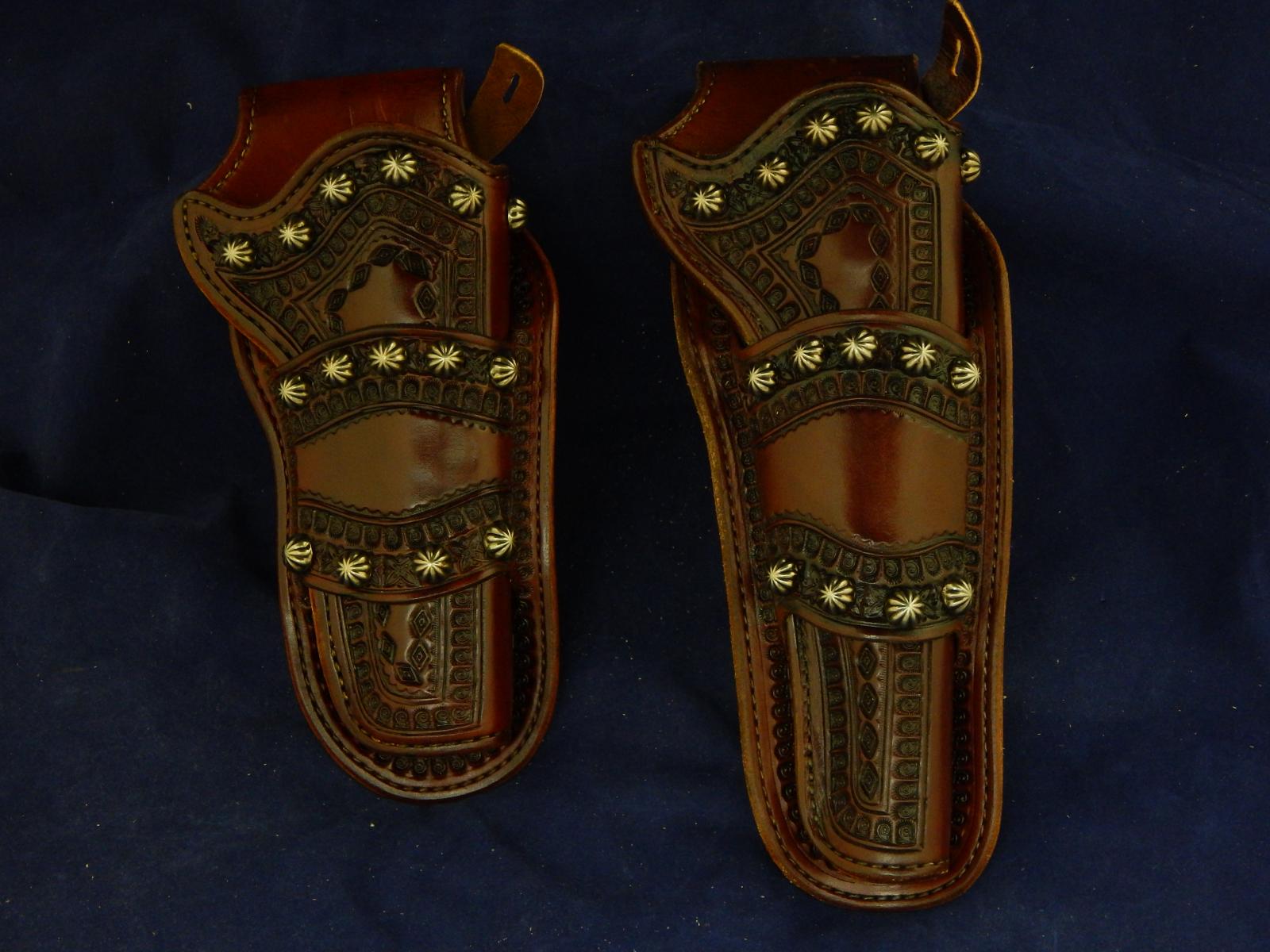

These are fantastic!  Can you share the color combination you used for dye/antique?

Start with Chestnut Wickett & Craig.  Once finished and assembled, give it a GOOD slathering with pure neatsfoot oil.  When the oil has penetrated, liberally apply Feibings medium brown antique stain (liquid, not the paste.) When the antique is dry, pull off the stain with wet paper towels until you stop getting color on  the paper towel. When dry from the wet paper towels, seal with resolene. Finish with a dusting of spray shine.  easy pessy
YinTx
That is incredible.  I love how you did that.  I don't have any of that leather, but maybe in the future.  I want a holster of my own just like that, lol.  I have stored it in my inspirational file.  Thanks so much for the details!
