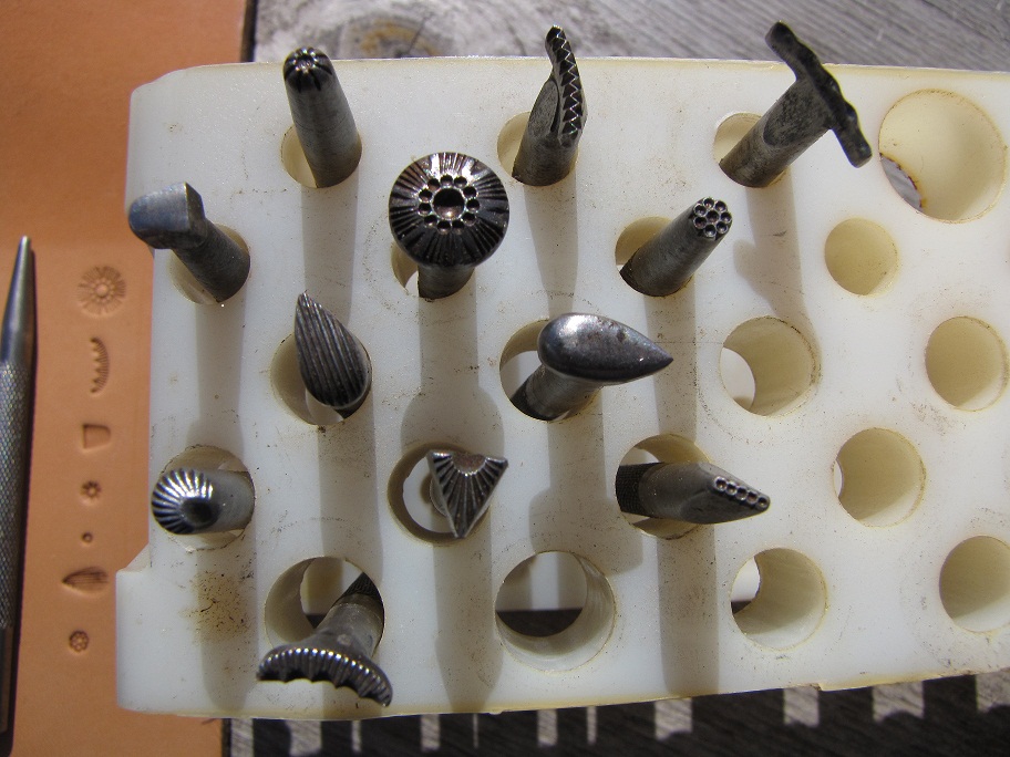

BUT, the intriguing part of the buy was the 13 no name steel stamps in the mix. They are shorter than the Craftool stamps (3.5" long) and very nicely made. They are not stainless, and are not plated. I will try to take a pic of them later, but dont have pic access right now.
The tool faces are sharp and well defined, and the handles are knurled like Craftool stamps.

Heres some pics.
Sure, I know as much as you are ever going to know about who made them unless you can trace the ownership of the tools back through the auction house. And no, they were most likely not made by McMillin. There is a seller on eBay who infers that every old steel non plated tool he has for sale is a McMillin. The historical fact is that is was part of the apprenticeship of many saddleshops for the wannabe saddle maker to make his own stamping tools. And then there were others who made tools for saddlemakers in their area. Due to the fact that these have knurled shafts, and the regularity of them, they were at least partly made by a machinist. From the fact that they could use some touching up, I would say he was not a leather carver.
From the impressions pic; going from left to right, top to bottom
Top row
The bargrounder needs to be ground down all around to make it work right.
The "pine tree" is very well done, though with not as fine lines as a McMillan or older Craftool.
The cam is very typical of old style cams in that it is more rounded across the top.
The wiggler (sawtooth style) is very good.
The wiggler (wavy style) looks okay but I am not impressed with it's impression. LOL
The smooth shader looks a little flat for my taste
Bottom Row
The flower center looks very even - kind of an unusual line pattern there
The veiner looks a little "clunky-thick" for modern tastes - I have several old timers that are like this
The beveler - has the round heel like I see in many old bevelers which is a good thing
The big seeder-definately done by a machinist with an indexing tool as it's so even
The ribbed shader - very well done for being done freehand, I've seen worse.
The birdseye backgrounder - definately done by a machinist, but like the bargrounder - needs touched up. You should notice that the pattern of 7 dots surrounding the center one is a bit unusual. The usual was 6 or nine dots.
All in all, you have got yourself a nice little collection of very old tools dating back a half century or more. If I had to be more exact I would guess made in the 1940's to mid 50's. Since you live in dry country like I do, they shouldn't rust badly on you. I use Rain-X to coat mine with just to be sure. Below is a pic of some more "oldies" that I've accumulated over the years.
