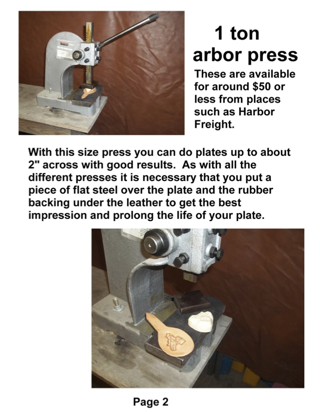

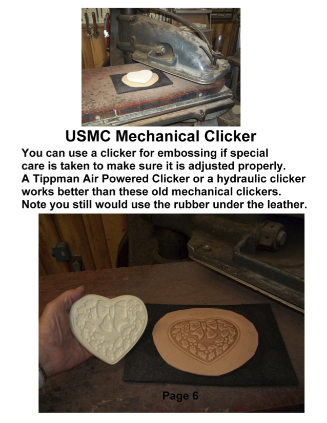

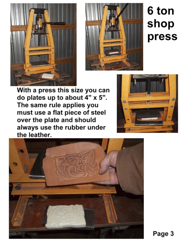

This is some Leather Embossing information that was put together by Raymond Tipton of duckcreektraders
Raymond & Patty Tipton have been in the saddlery and harness business for some fifty years....
They also have a Website Bunkhouse Tools
post-15330-036818700 1339900735_thumb.jp post-15330-054914400 1339900829_thumb.jp post-15330-059277200 1339900893_thumb.jp post-15330-053838000 1339900955_thumb.jp post-15330-057116700 1339901107_thumb.jp
post-15330-036574600 1339901244_thumb.jp post-15330-070324300 1339902241_thumb.jp post-15330-046024600 1339901459_thumb.jp post-15330-070198100 1339902297_thumb.jp
I thought this information might be of some help to others here.
