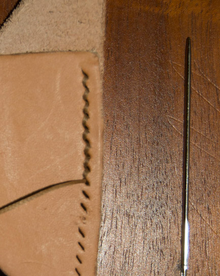

Chain Report post Posted January 10, 2015 I have just bought one of these http://www.goodsjapan.com/european-leather-stitching-chisel-leathercraft-pricking-iron-tool-6x3mm-1596-p.asp%C2'> and also the 2 prong one. I have only just sewn 2 pieces of leather together to try them out. The holes are not thick, in fact they can be a little tight which can be a good thing. They seem quite good to me though Quote Share this post Link to post Share on other sites
pgivens Report post Posted January 10, 2015 I have just bought one of these and also the 2 prong one. I have only just sewn 2 pieces of leather together to try them out. The holes are not thick, in fact they can be a little tight which can be a good thing. They seem quite good to me though That's great. Would you be able to post a picture of the stitching you did? Quote Share this post Link to post Share on other sites
Chain Report post Posted January 10, 2015 The stitching is a bit rough, so are the pics but I was just trying it out. Quote Share this post Link to post Share on other sites
pgivens Report post Posted January 12, 2015 What size thread is that? And which SPI iron did you use? Quote Share this post Link to post Share on other sites
Chain Report post Posted January 12, 2015 SPI is the same as the one in your link 8.5. The thread is .6mm Quote Share this post Link to post Share on other sites
JanC Report post Posted January 12, 2015 SPI is the same as the one in your link 8.5. The thread is .6mm Can you comment on how sharp they are? Did you have to sharpen them at all? Thanks! Quote Share this post Link to post Share on other sites
Chain Report post Posted January 13, 2015 I would not call them sharp, and they don't really need it as can be seen in the pic Quote Share this post Link to post Share on other sites
