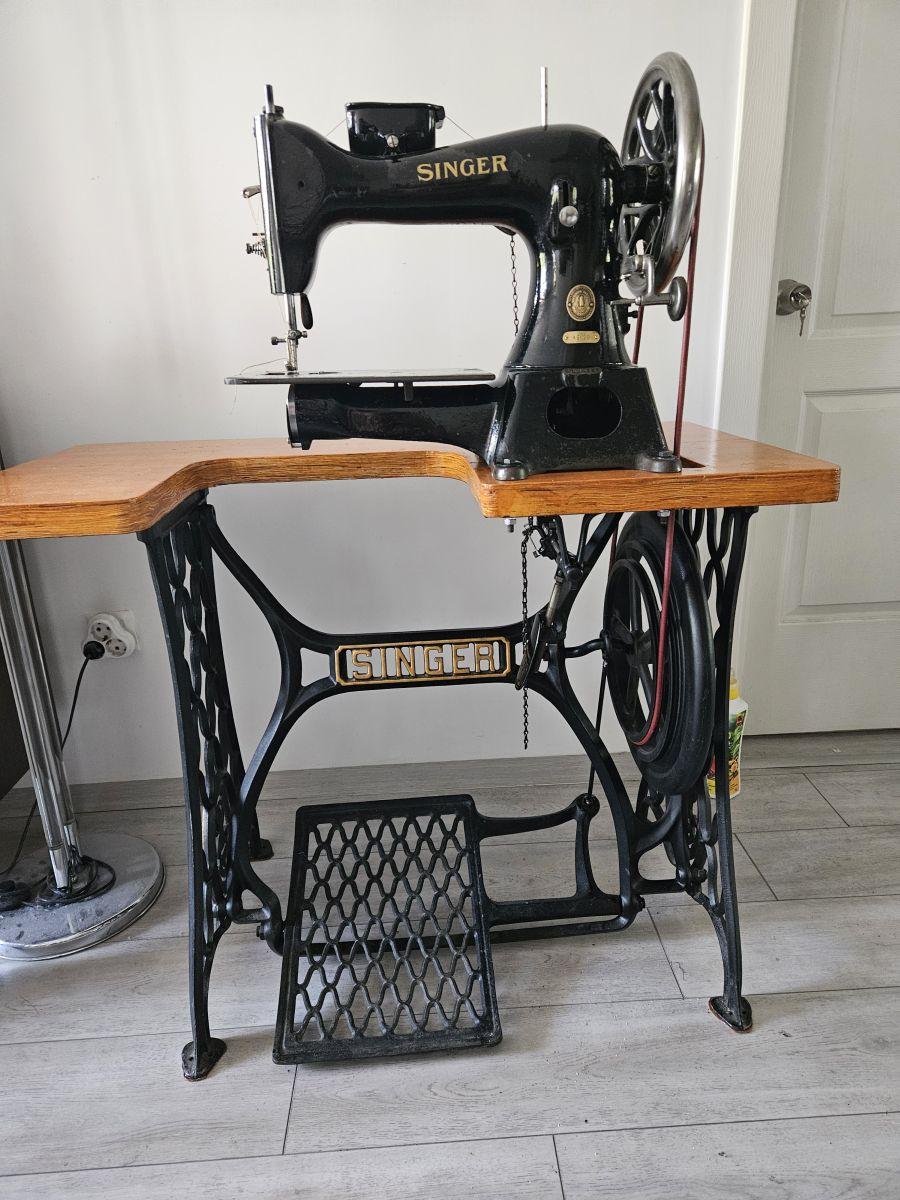

With the help of this web site and your valuable suggestions,I have already completed my 45k25 table and knee lift projects. I would like to thank member nickname âjimiâ for sharing machine table size post at https://leatherworker.net/forum/topic/74406-singer-45k-treadle-base-parts-information-or-parts-list/ by means of this subject I could reshape my old fur sewing table with jigsaw. and also member nickname âfriquantâ for valuable video sharing . Even though I know knee lifter mechanism ,I could not imagine application with chain, and watching this video made my work. I bought an original Singer knee mechanism from one of dealers in my city,but I couldnât find the hook like part,instead of this I used allen no 7 and 1.5 . I drilled a hole on 7 and inserted into allen 1.5 as âhookâ for pulling chain mechanism. I tried and it seems working. Thank you đ -

I have complated my singer 45k25 table project by cutting old fur sewing machine table. I attached the main body but how can I activate foot lifter .I couldnit find any clue from old writings.For new machines it is called as knee lifter I guess. What should I do for activating my machine chain shaped foot lifter?
