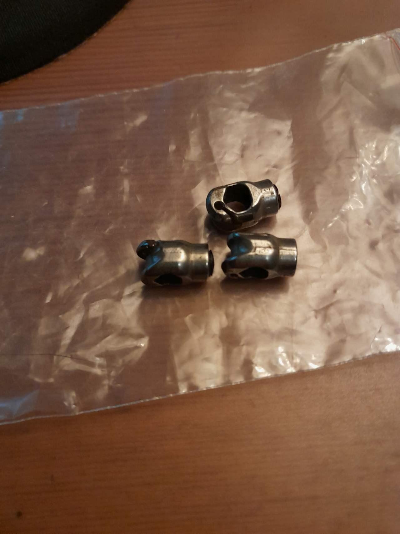

  1. I think it should be these (I have a few):
