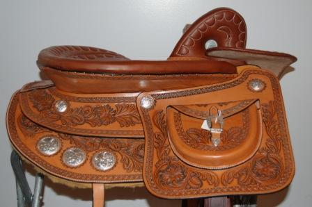

  6. Here is the latest show side saddle that The Side Saddlery built and sold to a lady in Texas. The saddle is built on a Steele tree. We used calf skin on the seat for better grip. We wanted to avoid the inevitable wear you get on suede. We ran the balance strap under the skirting to avoid breaking up the lines of the skirts or hiding the carving. The near side is covered by the lady's skirt or side saddle apron, so the carving & silver is limited there. We didn't feel we needed to "chase" fashion in the Arabian ring since side saddle is so different anyway. The saddle is meant to look a little "retro" and different from what anyone else might be riding. I hope you enjoy these pictures. I'll also post a Goodnight western sidesaddle we rebuit from the antique tree out in a separate post. Linda
